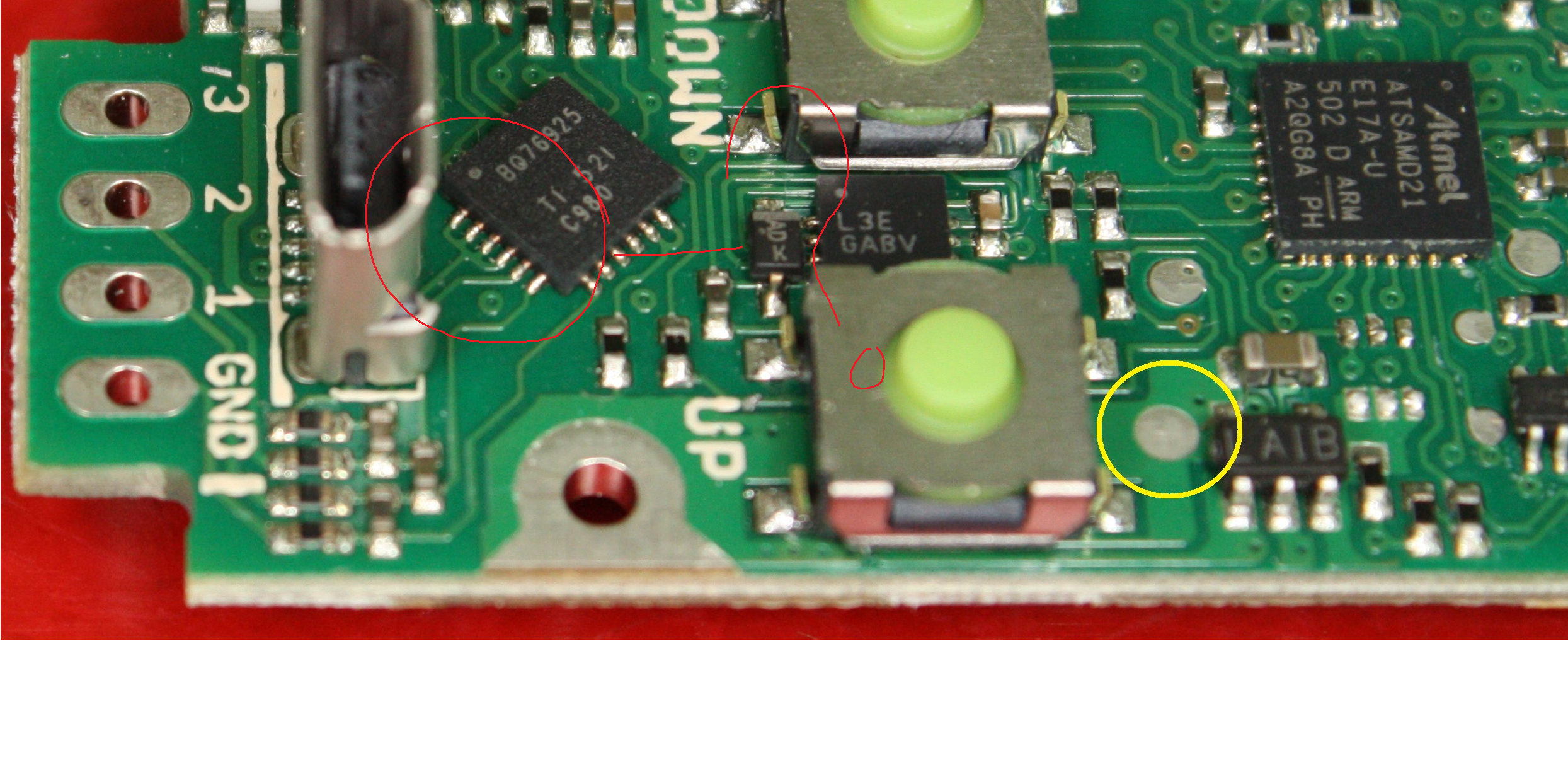

ya i don't think they're missing. i just think with the way these ic's come and reflowed from under the chips combined with the conformal coating, you're not gonna see the solder connections that well. i'm going to rule out broken or missing pin outs.
The 2 middle pins on the bottom right side of the chip are either missing or tucked under the chip. Its bottom right if you you hold the board vertical with the usb port at the bottom.[/QUOTE]this is what it should look like.
that square chip you're referring to is called "host controlled analog front end" (i think i'm right) it's job is to monitor, balance, protect, the battery pack. pretty much the heart of the charging circuit on the dna 200. if you can get a good picture of all four sides that could help to see if any legs crapped up. if that's the case, you're def looking at an rma.

well it's looking more and more like an rma situation. sorry to say it, but you're confirming correct voltages at the taps and mains on the board, it sounds like something that cannot be fixed by you. if it were me, i would see how the boards with a pack directly soldered to the board, taps and mains. i'm out of ideas.
i was gonna say solder the balance leads from your old lava battery directly to the board. and see if that corrects the problem
from what i can see nothing looks misplaced to me. i would rma the board back to evolv. not unless someone else comes up with any ideas. if a cell's voltage is fluctuating, sounds like a bad connection somewhere (intermittent connection).
pack seems good. have you tried a hard reboot. reinstall your firmware? do you know where to look for knocked off resistors or other components? it can be very hard to see and catch everything since they're so small. let me see if i can find the pic with the resistor knocked off the board.....
