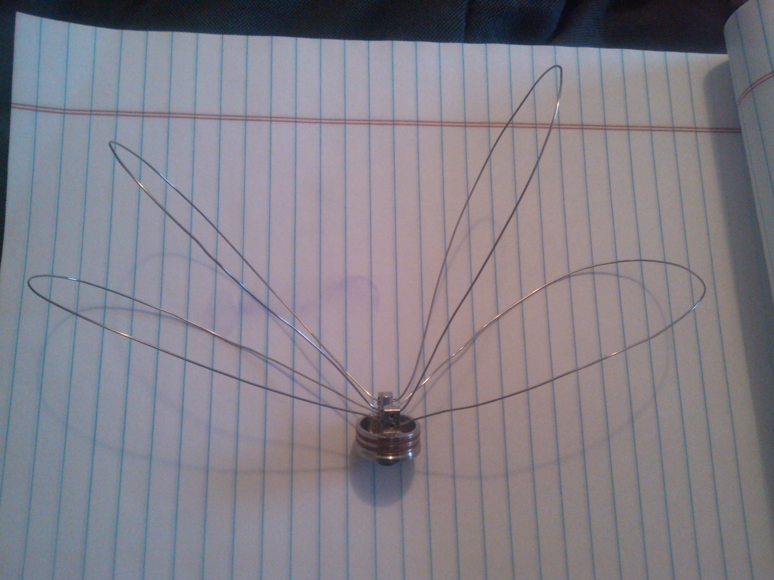

i make four loops of 22 gauge kanthal in my velocity clone which ohms out to .29 . here's what mine looks like. more loops means it dissapates heat faster. have you read through the thread on how to run battery analyzer? -
