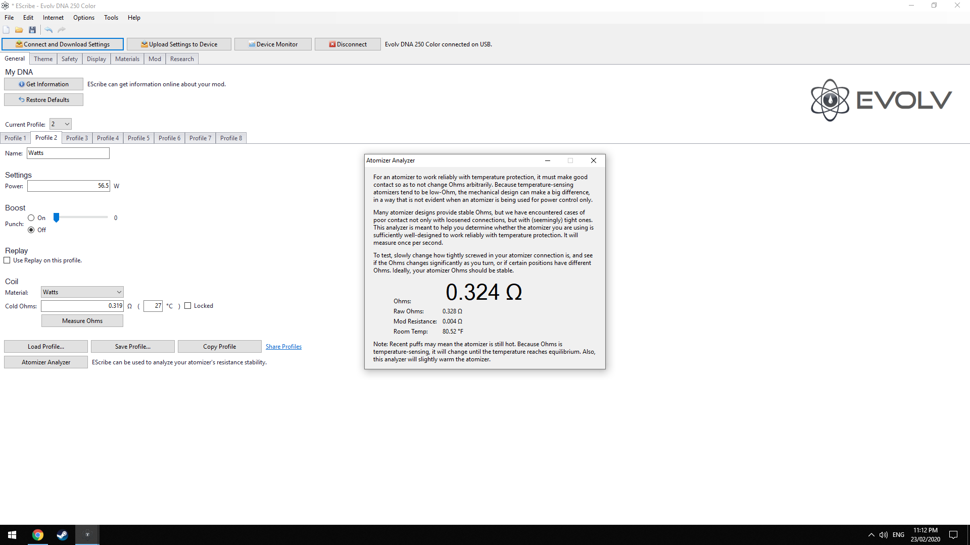

Yeah si now i have a single 0.22 ohm alien coil in the mod, its reading the wrong ass ohms, as you can see in atomizer analyzer. But live ohms is correct. does this matter? is it stil "working" correctly or is there any danger to me or my mod or both? all i want to know is if i can stil use it? or is it vital that i get it fixed?

So i just got a newly finished 4s lipo box mod with a dna 250C chip in it. when i put an rta on it it reads the coils at 0.37 ohms. wich is wrong. i know for a fact they are 0.22
when i go into the diagnostics menu on my mod and fire the mod there the ohms read out 0.26 which is much closer to the truth. so im wondering can i use the ohm readings in the diagnostic screen for the front screen in wattage mode by editing the theme in escribe ? or is there a way i can get the ohm reading to just be accurate to begin with?
