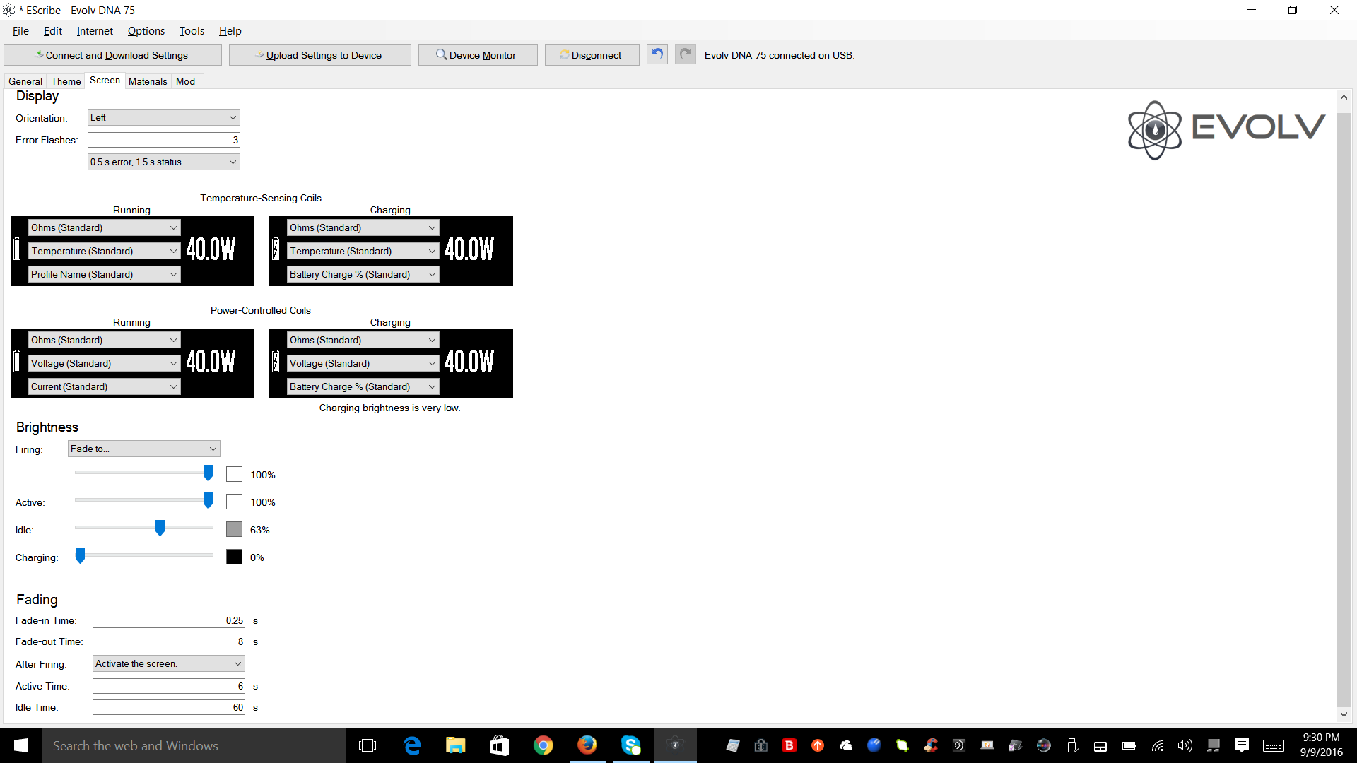

Ok, I am doing the same thing here as you are doing there. When plugged in to charge it is doing what it should and you should see a red LED light (and lightning bolt) while charging turning to green (and no lightning bolt) when charged. With the Charge brightness set at 50% and not plugged in to charge the screen should go out after 60 seconds or so. So the original ecig file that came installed in the device has not been changed? If it has then it may be the ecig file you installed may have an issue. If the ecig file wasn't replaced from the original then you may have a board issue. That's my best guess from what you are seeing. Has it done this from the start as a brand new device? What device is your DNA75? -

OK, when you change only the Charging brightness to 50% what happens? What does it do while plugged in to charge and also not plugged in to charge? -

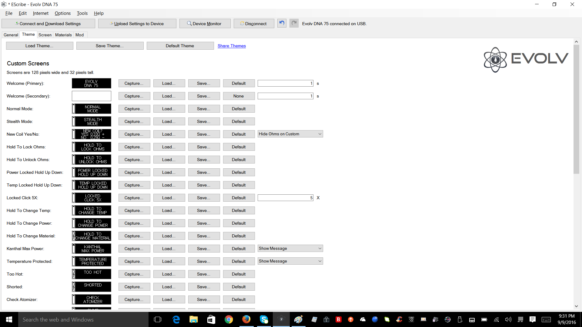

So when you have only default settings (no changes made whatsoever) on the Theme Tab and on the Screen Tab it still never sleeps? Can you post screenshots of the Theme and Screen Tab's showing all DEFAULT Settings? -
