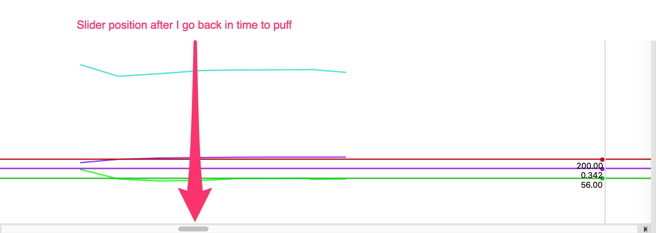

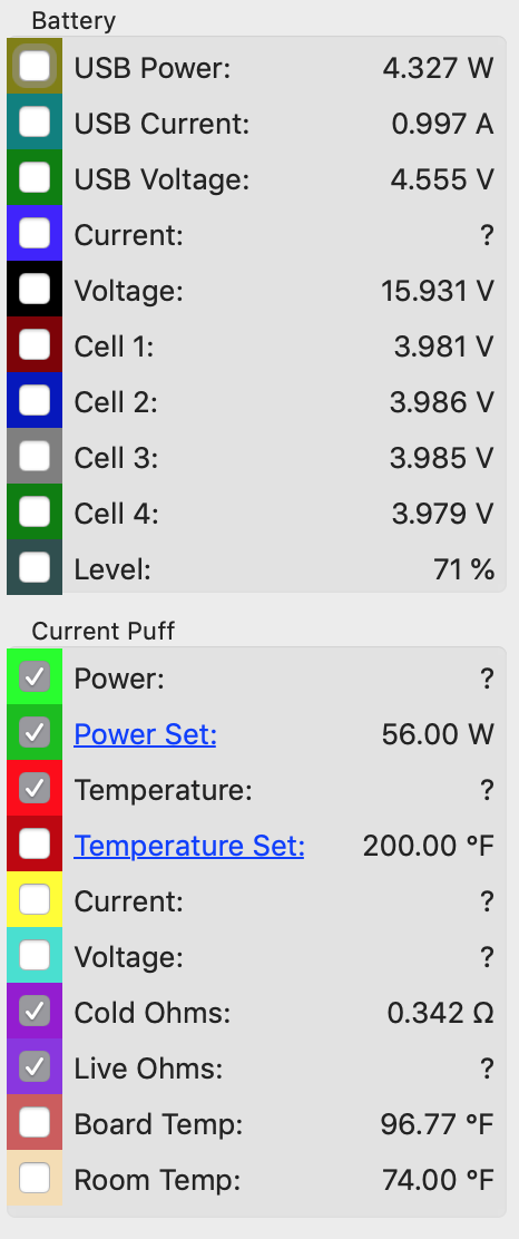

A 0.03 drop is nothing to worry about at all, especially with a Kanthal coil in power mode. Surprised you could even see that on the screen, but next time if you're concerned, you can Post a screenshot like above while firing, showing that behavior 🙌
