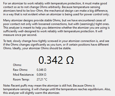

From here, I figure okay there might be something really wrong with my build so I start doing some checks in the Atomizer Analyzer. Though I do see changes in the ohm reading after a 180 degrees rotation, I'd argue the change in ohm reading is negligible at best.
Am I doing something wrong here, or are there any settings I can fiddle around with to get the most of out my 250c, given Replay is pretty much the selling point of this chip?
