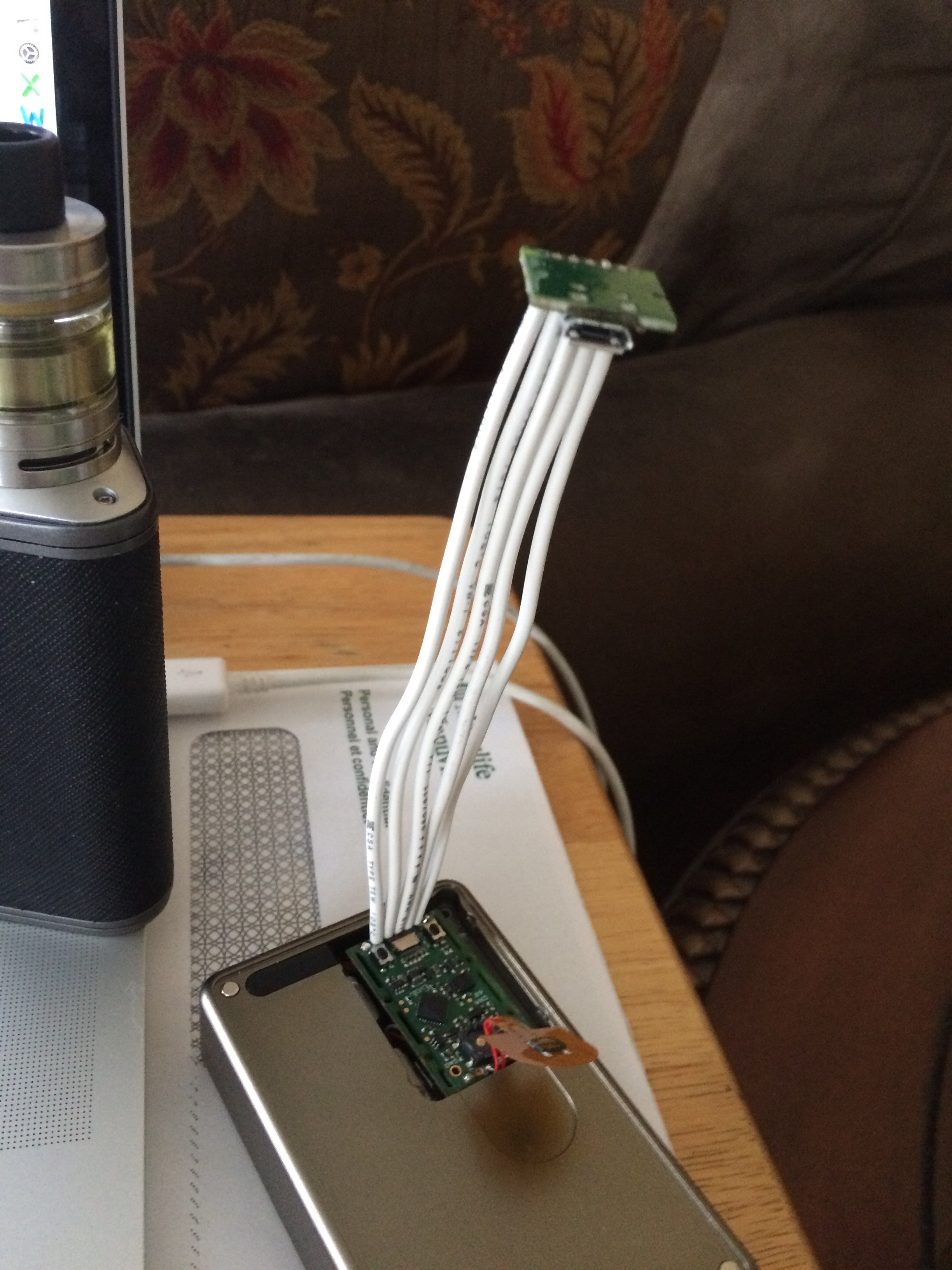

You should look through this datasheet and also pick up some silicone sheathed wire and jut rewire it completely. Ideally you have an electronics store nearby, or maybe even stealthvape. You'll only need a max of 4 wires about 6 inches of each (max) https://downloads.evolvapor.com/dna75color.pdf -

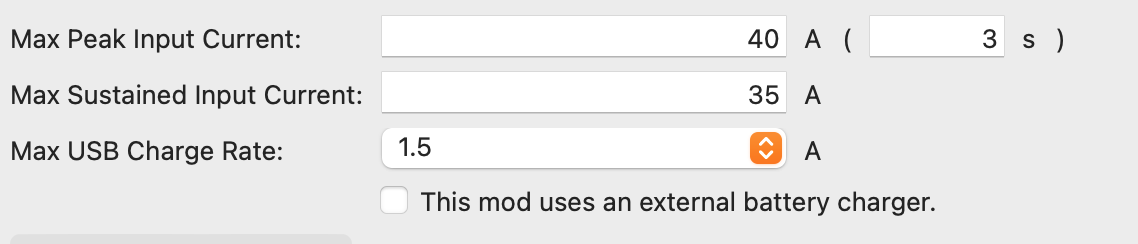

Brought to you by the same people that do not recommend firmware updates. 🙃 They missed the word (externally, about that 3A max) I'll quote what I said 6 days ago elsewhere "That simple swapout to charge means you’ll be using a Lipo charger. Depending on how you vape you might get away by just plugging your mod into 2A charger during the day. Remember it’s really 4@1600 mAh cells, each charging at 2A/4(cells) or .5A each. Your mod comes with a great balance charger for th batteries." You can use your 3A charger (I use a much more powerful laptop charger) because your mod will only ever draw 2A max. -

That's the same distance as the 100C, so the buttons should line up. It might be tight in there. Here's the drawing of the 100C if you want to check even more. https://www.stealthvape.co.uk/product/evolv-dna100c/ Good luck. -

Device Monitor uses that battery curve voltage value for the Level % after the 4 cell voltages BUT If you're gonna follow the screenshot @dwcraig1 showed, see that label in his pic that says 'Maximize puffs', that MUST be changed to 'Maximize recharges' for charging to stop at 4.10Volts
