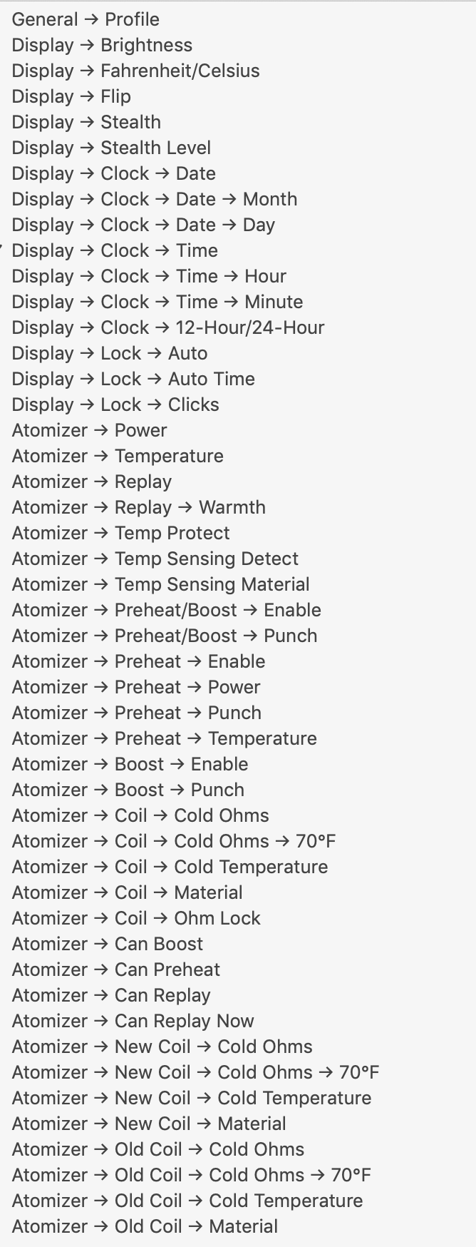

That's pretty much the timeout right there. If you want the exact time, use a stop watch and see how long it takes for the little * to disappear on your screen when your mod is locked. There is no csv, but themes can be used to manipulate nearly all mod parameters like escribe. Most field names are relatively descriptive and you could take screenprints of what's available in Theme Designer. I stitched 3 of these together onto 1 page.
