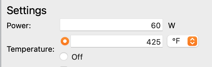

Thank you. So taken from zivipf; Alloy components: Ni 52%, Fe rest Temperature coefficient: 400 Well you do have the correct material file. so that's good. My 'ugly head' comment refers to Ziv using the '48' to identify the Iron content whereas steam-engine uses '52' to identify the Nickel content. Using escribe with your mod plugged in can you go to your SS316L and NiFe profile and make sure or change so that the temperature box under settings is chosen. (same thing as making sure the 'Off' is NOT highlighted) and let me which material had the 'Off' highlighted. Make sure to Upload settings to mod whenever you make ANY changes in escribe. Another way your mod could have got to 'Off' is on page 4 of the datasheet. Here's a snippet. 'The maximum temperature is adjustable between 200° Fahrenheit and 600° Fahrenheit. To disable the temperature protection entirely, adjust the limit up to 600 degrees, then press the UP button one additional time. The temperature limit will read OFF.' Here's where you can download the complete datasheet 'https://downloads.evolvapor.com/dna60.pdf' Edit: While you're in there (Material for NiFe52 you might want to change the 'On-Screen Name' from 'Ni' to 'NiFe or NiFe48' <- something no other mods can do
