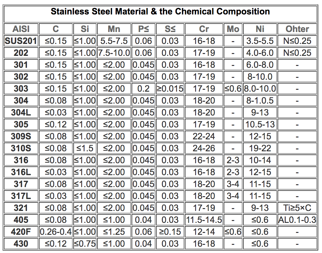

  20. So that appears to be the correct depth for the mesh, and a similar routine to what I suggested. I still stand by my full way. And don't lock the ohms/resistance. Wotofo probably has no clue. As @dwcraig said, all SS are alloys (a chemical composition) with ranges instead of hard and fast rules for what SS316 or 'L' is. The 'L' for example just denotes low carbon.
