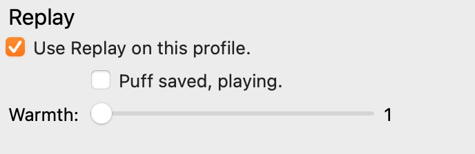

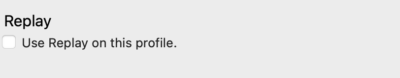

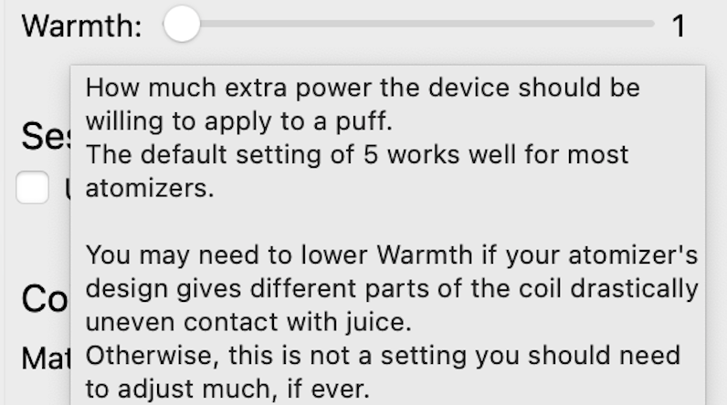

burning through coils too quickly in replay mode
Wayneo replied to ViileVillain's topic in DNA 250 Color
Turn down 'warmth' -
How long did they last when not using Replay? Why do you think Replay is causing them to burn quickly? Is this a new ejuice?
