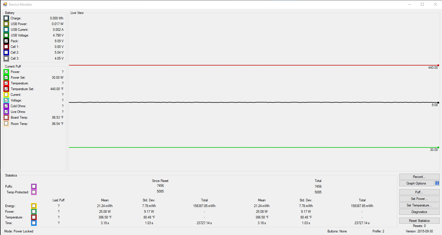

Wake-N-Vape Posted December 12, 2015 Report Posted December 12, 2015 I just ran into a similar issue with one of my Reuleaux's (just like Brett's). Has been working great for the last month since I got it. I decided to update the settings in eScribe for the battery soft cell cutoff tonight for some reason... But that was a mistake. After successfully updating the settings, the device then would read check battery every time the fire button was pressed even though it was working fine before (note change from 3.2 back to 3.09). When the device does not have a USB power source plugged in, the screen only lights up with the Wismec logo for a split second, then goes dark. Holding the fire button will allow it to power up (once up, will get check battery repeatedly), but letting go of the fire button instantly turns off the mod. I am using three Sony VTC5 batteries that I purchased with the mod and they were not removed at any point during the updates before or after. So, after digging into eScribe to check the voltages in battery analyzer, here is what I have found: Cell 1 = 0.00V, Cell 2 = 5.04V, Cell 3 = 4.05V (which is the actual voltage of all three batteries when tested with a multi meter). Swapping the battery positions makes no difference to the readings, but the cells do seem to drop over time. There is a weird kind of fluctuation happening in device monitor (no atomizer attached) of the pack voltage that I think is responsible for the cells dropping over time (Screenshot Below and barely visible squiggle). So, I assumed that maybe one of the wires was burnt through and maybe causing some sort of short to occur? And, against my best judgement... I went ahead and took it completely apart to inspect the board, battery sled, and wiring for any visible damage. To my surprise, there was no visible damage, nothing missing or damaged on the board (that I could see), and the wires (while ridiculously thin) were all fine as well with what seemed like solid solder joints inside the sled compartments and to the board. So, I put it all back together, and slapped the batteries back in... Same thing. And, after doing some reading, I went ahead and tried a battery magnet on Cell 1 just to see if it was a connectivity issue. It was a pain getting that magnet seated properly, but seemed to make a completely solid connection and had the negative pin pretty much fully depressed. Of course, that didn't work either...I have also tried downgrading firmware, re-updating the firmware to current, reset to device defaults, hard-boot, soft-boot, cleaning contacts, cleaning 510 threads and the spring-loaded pin. None of which has made any difference whatsoever. Now, I should mention that I typically charge this reuleaux with the USB port on the mod. However, I also have 2 other sets of married VTC5s that are charged externally that I tried putting in the mod, and while the voltages were different, two things were consistent. Cell 1 = 0.00V, Cell 2 > 5V, and Cell 3 = Actual Voltage of all 3 batteries.Does anybody have any idea what would be going on here?? Seems to be something with the battery tray or its connection to the board, but I cannot rule out the board itself either since an eScribe update caused this to occur (although that seems like it may have been coincidental). Have you seen this happen before Evolv? If not, would you like me to send you mine for diagnostics and possible repair to help others that have/will run into this in the future? Or, if there is anything you think I should try on my end... I do know how to solder and work with batteries from years of RC experience. Sorry for the lengthy post, but I figured I might as well give as much information as possible so others don't spend 3-4 hours worth of troubleshooting that gets them nowhere.

Jaquith Posted December 12, 2015 Report Posted December 12, 2015 Wake-N-Vape said:..., here is what I have found: Cell 1 = 0.00V, Cell 2 = 5.04V, Cell 3 = 4.05V (which is the actual voltage of all three batteries when tested with a multi meter). And, Jaquith... What you need to understand is these devices have battery profiles for VTC5s that were custom made by me in my second reuleaux.The fact remains you're suggesting something is wrong with the Reuleaux DNA 200 and I'm personally attacking. You took the Mod apart, the voltages are way off and the batteries are severely out of balance. To add to the problem the Battery Profile values you set clearly are not for the Sony VTC5's. You confuse something I'm saying as 'personal' when in fact I'm attempting to explain probable facts and solutions for your problems. I'm here to help solve problems nothing more.Sony VTC5 Battery Profile and settings (10A battery profile; 24.81 Wh, 2.5V Cutoff) http://www.filedropper.com/sonyvtc5batteyprofilesdna200What I'd recommend is to:1. correct all user assembly errors2. fully charge (4.2V) new Sony VTC5's externally;3. update Escribe, firmware and battery profile;4. hard reboot and try again.Whether you decide to follow my suggestions is purely your choice and business. All I know for a fact is everyone using my Reuleaux DNA 200 settings and suggestions are reporting no problems.

Wake-N-Vape Posted December 12, 2015 Report Posted December 12, 2015 Jaquith... The fact remains that something IS wrong with the Reuleaux DNA 200. The cells ARE NOT out of balance as verified on a multi-meter as well as verified by my 4 bay charger and three different married sets of VTC5 batteries. Please read thoroughly before responding. I spent hours reading and researching the forums to reach these conclusions and waited until I had all the information in front of me before posting this (scientific reasoning).I appreciate you trying to be helpful, but in reality you are not and are personally attacking based on YOUR experiences. (replaced by another made-up arbitrary number - correct all user assembly errors), there is a way to say those in much nicer and more helpful ways and not come off sounding like some sort of disgruntled know it all. I appreciate you taking the time to reply, and for your suggestions. But, please know that they have all been tried without success (as mentioned in original post), that I do indeed have the correct battery profile loaded (also mentioned in original post), and that I am very well versed in building micro electronics with my hands without any errors in assembly, let alone putting something back together that was already built. I don't appreciate you acting like I must be doing something wrong and that you have ALL the answers.Also, the cell soft cutoff can be set to whatever the user wants as it is purely a subjective setting if it is any higher than the minimum cutoff. It will not affect battery performance one bit. It does not NEED to be less than Evolv's preset setting. Please choose your words more carefully. Lets take RC lipo packs into consideration here. Most RC applications cutoff at 3.4-3.6 volts (in my experience with RC Helicopters) even though they can go much lower than that. The reason they are cutoff at that point it to protect the integrity of the cells as well as maintain charging characteristics for many, many cycles. Can you run them lower? Sure... Will it affect the longevity of the batteries if they are run down to the minimum? Absolutely. Will setting a higher cutoff hurt anything? Nope, it won't. While me changing the soft-cutoff seemed to have caused this, lets just go ahead and rule that out right now considering that value could not cause this behavior and move the discussion towards other aspects that could be potential issues. There is an entire thread about the cutoff values, and I have been through the entire thing. I am more interested in why this happened after updating the settings via eScribe? And, if not eScribe, then what piece of hardware should we be looking towards fixing?
Jaquith Posted December 12, 2015 Report Posted December 12, 2015 [QUOTE=Wake-N-Vape]Jaquith... The fact remains that something IS wrong with the Reuleaux DNA 200. The cells ARE NOT out of balance as verified on a multi-meter as well as verified by my 4 bay charger and three different married sets of VTC5 batteries. Please read.. Originally Posted by Wake-N-Vape ..., here is what I have found: Cell 1 = 0.00V, Cell 2 = 5.04V, Cell 3 = 4.05V (which is the actual voltage of all three batteries when tested with a multi meter). [/QUOTE] The what?! I quoted your reply above where you said they 0V, 5.04V and 4.05V which were the same on the Mod as on your Multimeter?! Those values are crazy out of Balance! I read those as Actual voltages. The Balancer if cells, batteries, drain unevenly .. charge and repeatedly go through steps to balance the cells. Anytime the actual voltage per cell is unbalanced past +/-0.3V, depending on the balancer over and under charging is possible. To add to the problem, programming (firmware) looks at set values and it wouldn't surprise me a bit if erroneous values are the root to problems. In this case a cutoff > profile value; in other words error handling; the programming can handle a < or <= but not a > conflicting value. I'd try what I suggested, and perhaps add to the Mod's charge and perhaps the Default screen to show Cell 1, Cell 2 and Cell 3 and keep an eye on the Cells.
Wake-N-Vape Posted December 12, 2015 Report Posted December 12, 2015 Those values are how the chipset/mod are reading them... Those are not the actual voltages of the individual cells/18650s... Cell 3, as read by the chipset/mod is reading the actual voltage of cell 3 accurately... And, when the batteries are swapped in position, cell three always says the same voltage regardless of battery position. Furthermore, testing them with a multi meter and an advanced external charger, have all three cells perfectly balanced and all three sitting at the same voltage as read by the mod on cell 3 only. My apologies if that was not clear, but that parenthetical statement was attached to cell 3, not meant to be interpreted for the other data given on the other two cells. That was one situation where i should have been a little more clear I suppose.I have attempted monitoring individual cells in eScribe as you mention, but this does not make any difference at all. And while I do understand what you are saying about the programming what it can handle (I am a programmer for a living)... I do not feel there is enough information to make the statement that they did not program conditional variables to protect against a > value. Furthermore, there would be no need to protect against this greater value. It will not affect battery discharge or performance even if you set it to 3.2... This just means you will not be getting the full life out of your batteries, and this is NEVER a bad thing if you expect your batteries to last for many, many cycles. If this is incorrect, then apparently the RC industry is doing it all wrong since these are the rules many follow in that industry. I do understand the nature of overcharging, under charging, discharging, and over discharging... But this does not explain why the mod performs the exact same way with three externally charged, married VTC5 batteries, all sitting at a proper 4.2v volts. Whether the batteries were charged by the DNA 200 correctly or not, the DNA 200 is not reading them correctly. I have attempted reverting back to the original settings I had when it worked (which was 3.2) to no avail. No other settings have changed since I put them on the deice almost a month ago. So, I don't think settings are to blame here. I have also tried 2.8 for the cutoff, which makes no difference either. There is something wrong with the mod and/or chipset... Batteries all check out and are perfectly fine. If I pop any of these cells into my second (working perfectly) Reuleaux, they all work fine/as expected. Like I said, I have spent hours upon hours trying to fix this, taking in all of the available information in these forums, ECF, etc... This is a problem very few have run into it seems. But, deductive reasoning has led me to two conclusions.1. Problem with the wiring (although not visible).2. Problem with the DNA 200 board (this happened after updating settings in eScribe after all).At this point, we are getting nowhere towards an amicable solution... If you had this mod in your hand, you would know where I am coming from and why I have reached these conclusions. Batteries are not the problem here. I do appreciate your input though and you trying to help.
