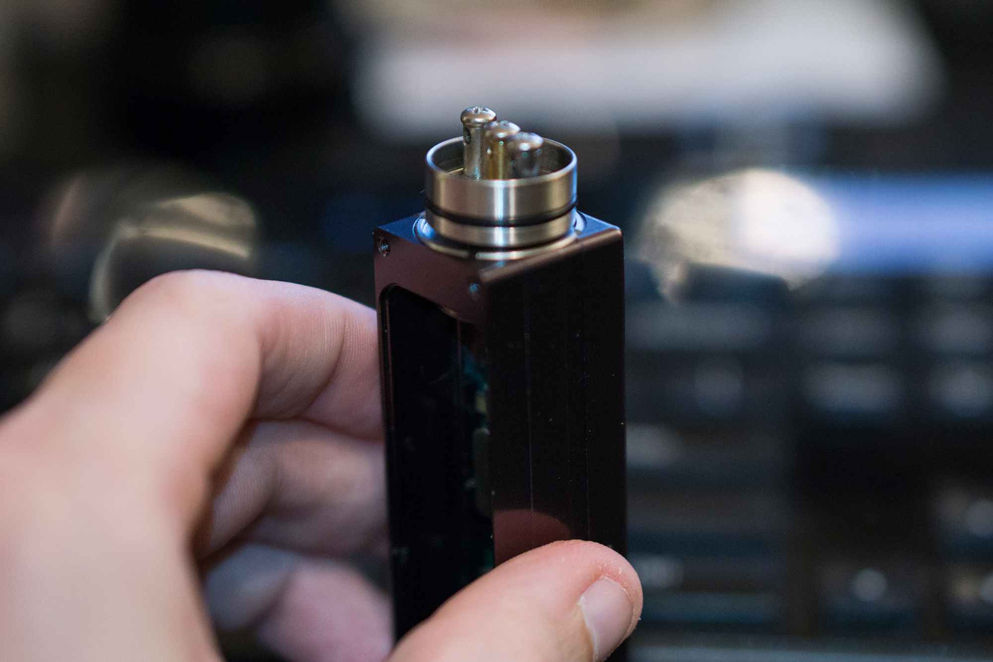

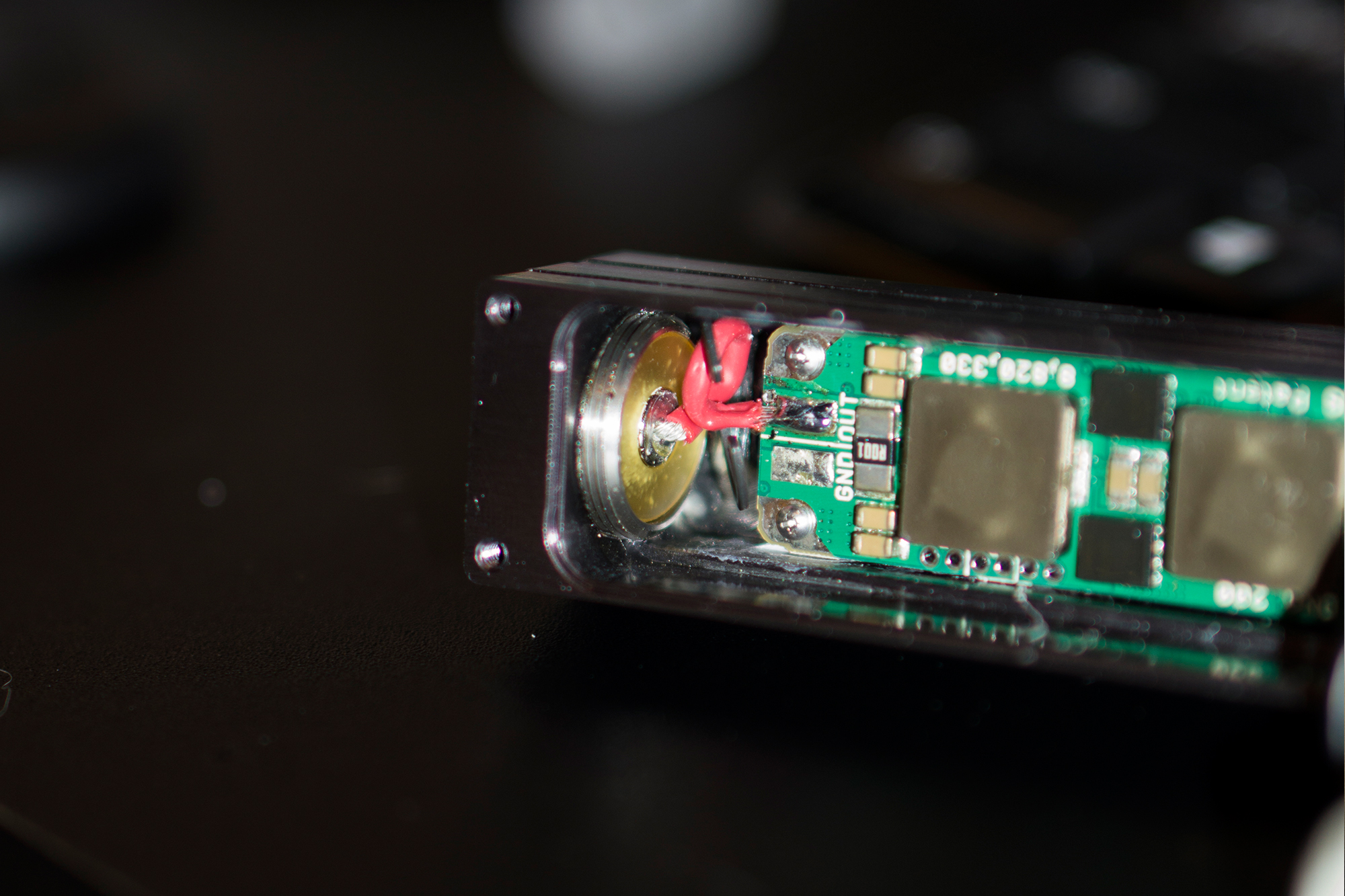

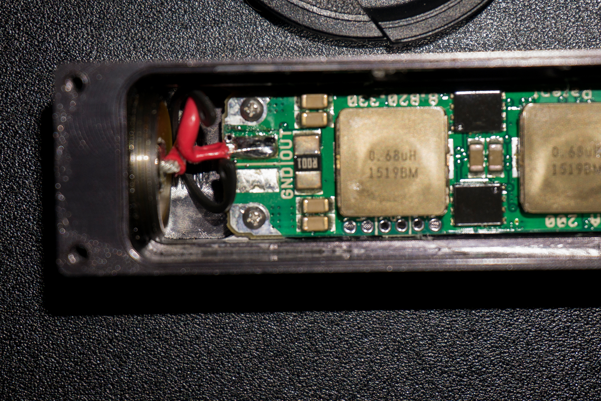

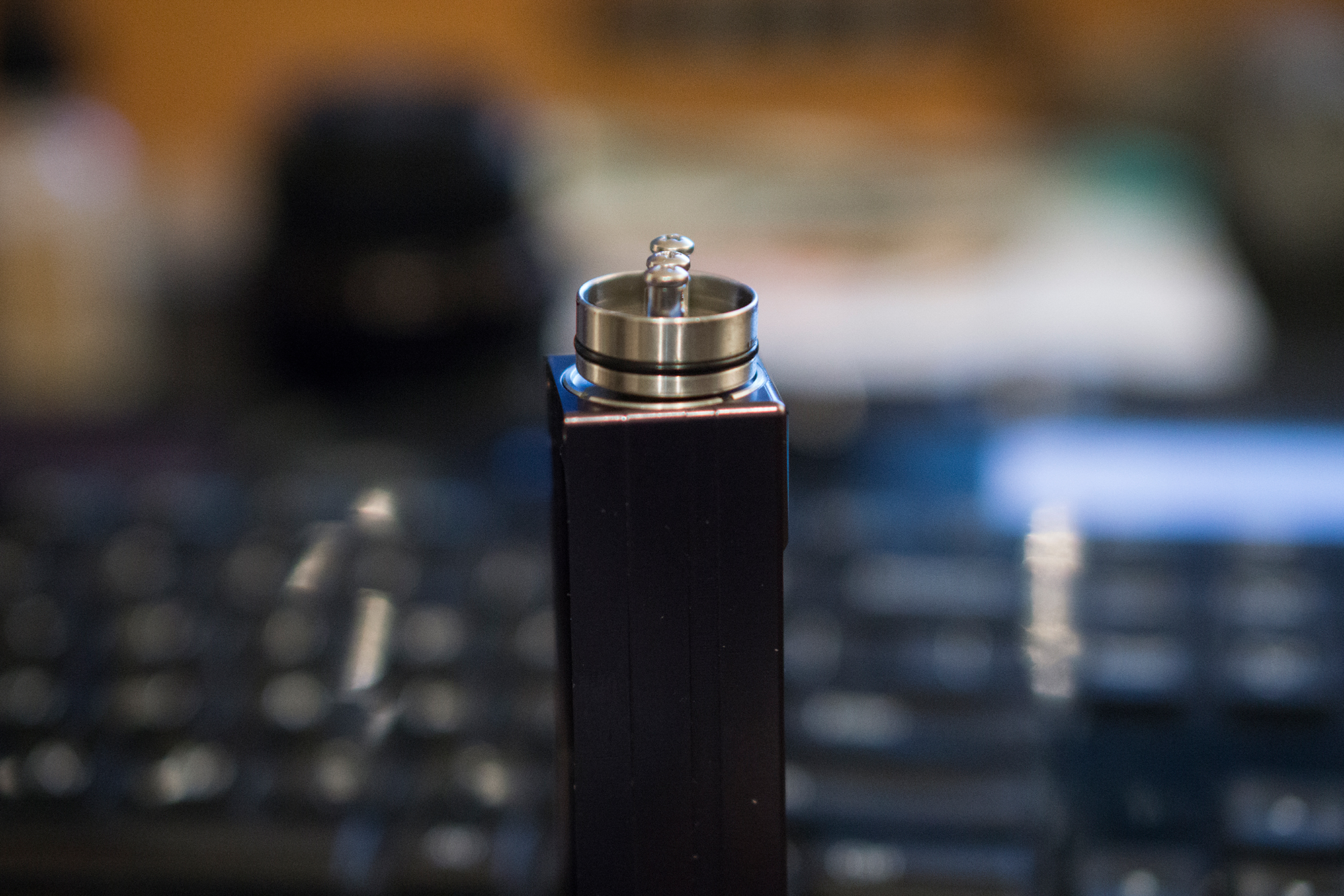

Well, I went ahead and got brave and cracked her open to see if I could figure out what is going on. I can also confirm that my positive and negative wires have also been soldered directly to the board as Monster mentioned. After cracking mine open, I noticed a loosely hanging circlip (photos) inside the case near the 510 connection. It appears that it has somehow pushed itself out of the detent that holds it in place which allowed the 510 pin to push down, but not return to the up position. After replacing the circlip, I can confirm that the vape is more consistent, and not giving me such bad resistance readings on my attys. However, it is still reading about 0.01 lower than my DNA 40's, but does not seem to make much difference in the vape quality at this point. The 510 Pin is still very stiff, and does not have much springiness to it at all? Hard to even call it a spring loaded 510 at this point... It does move up and down, but just barely. Upon reseating the circlip, the 510 pin is now straight without being crooked. I have attached some photos showing how the atty sat on the mod before the fix. Now, it sits flush as it should. Although my devices attach, something tells me that the circlip will dislodge itself again at some point in the future since the detent does not seem to securely hold it in place (and it popped out of place a few times trying to just put it back in). I can also confirm that the solder job is pretty bad at the 510, but does at least appear to be solid. My guess is The metal circlip was touching the exposed positive wire when it fell off causing most of the weird resistance readings. So, I suppose be on the look out for that issue.
Hello Everybody! Well, I unfortunately have another Hana V200 failure to report. I received my device yesterday and have had it running for around 20 hours now. While the device screen still functions perfectly (for now), I did discover yet another 510 related problem. The first device I screwed on was a Tugboat V2, and I immediately noticed that the 510 pin in the mod was crooked, and had very tight tension on it. Once I screwed down the atty, the 510 Pin did not spring back up as a normal spring loaded 510 pin should. This is just part one of the problem... Part 2: Because of the wonky 510 pin, I am also unable to get a consistent vape or consistent ohm readings on my atomizers (with Titanium GR1 & Steam Enginge TFR values - which is all I have tried). I have two DNA 40 devices that both report the correct resistance of the atomizer, but the V200 is consistently lower (around 0.02-0.05 depending on how it feels at any given moment). Because of this, Temp Protection kicks in almost immediately and does not allow me to get a sufficient amount of vapor. My guess is that the positive connection on the atomizer is not making a solid connection to the Hana's 510 pin... So, needless to say... At this point, I have an unusable V200 which will be going back to Hana hopefully sooner rather than later. I just thought I would share my experience here since I had not read of this specific issue as of yet... And of course, add one more to the list.
