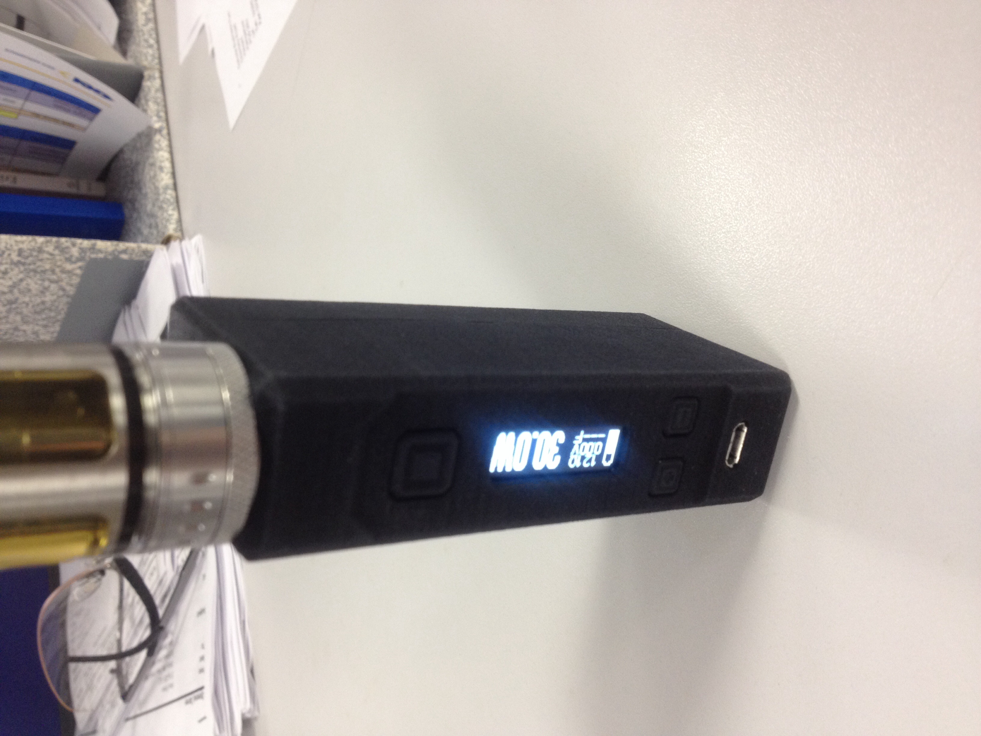

dsidab81 Posted August 5, 2015 Report Posted August 5, 2015 Finally have left my enclosure closed for a couple days, this 3d print copy of the reference case has very little room for error in depth. The side walls of the back chassis snugly hold this fullymax 900, so it isn't likely to be jostled....although i'm not sure of the shock absorption rate of abs.Many attempts at filing down the +/- buttons to not actuate when the back was screwed down. I ended up tossing out my xt30 connector and soldering the fullymax directly to the board. JST connector is still used for the taps.Considering 3d print plastic likely will not take well to repeated screw fittings, I don't plan on battery swaps!!Once someone gets the aluminum reference boxes up, I'm jumping in line to purchase.Definitely not as refined as several that have been posted, but my first foray into a mod this small....case: https://www.shapeways.com/product/6524725AS/evolv-dna200-case-with-buttons?li=search-results-1&optionId=57294605
Daz 7401 Posted August 5, 2015 Report Posted August 5, 2015 I like the orange buttons, virtually the same set up but with a Turnigy 950mah battery. It has been running for about 2 weeks and not missed a beat.
dsidab81 Posted August 5, 2015 Report Posted August 5, 2015 The orange buttons are already showing signs of color rub from the black. I may eventually paint them. You may notice I mounted my +/- backwards...luckily escribe has the ability to swap function!The same creator on shapeways lists only the chassis without buttons and buttons as a 3 piece for a few bucks.I am liking the form factor in hand, but it just feels very light coming from using an aluminum mod before.
