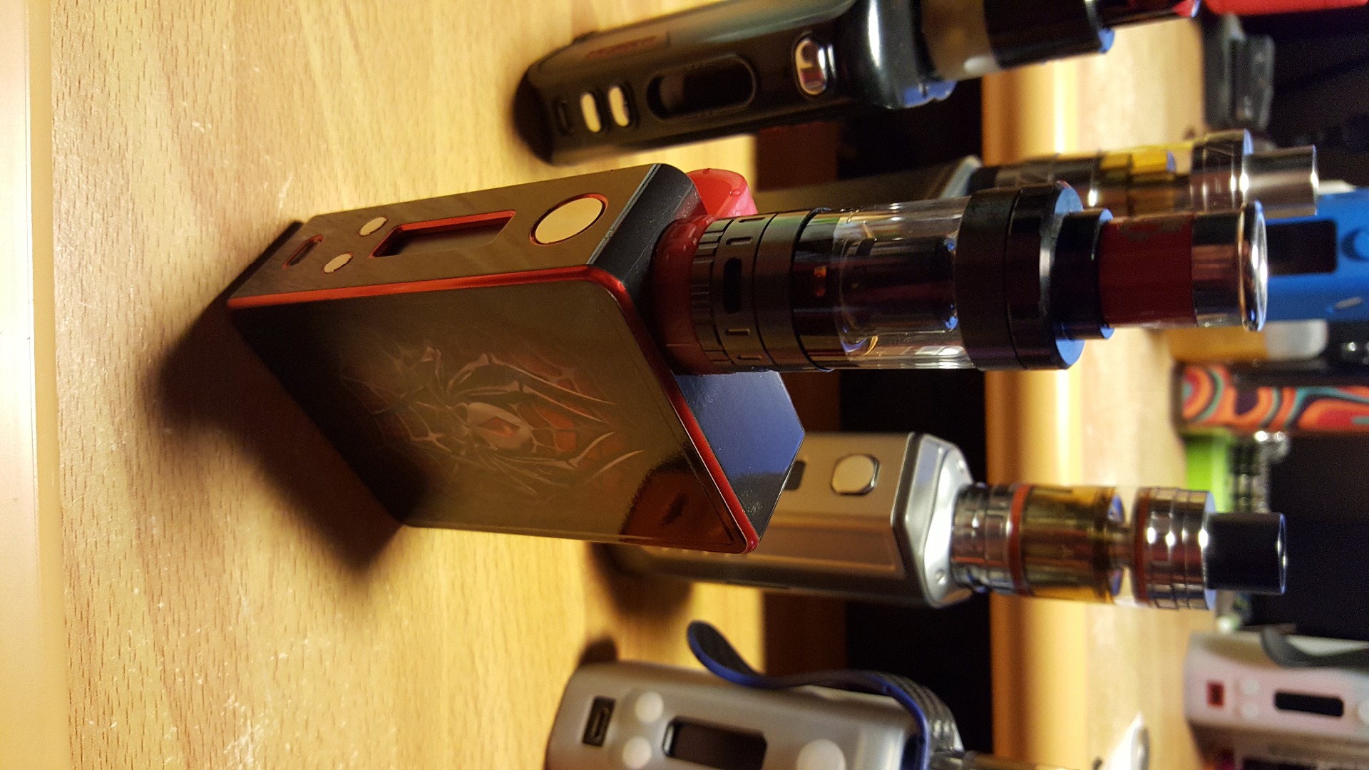

Just wanted to share one of my dna200 mods. I seen on Facebook a guy who built one kinda like this and I had to make my own. Alpinetech A+ brass buttons and a brass cap for a FDV v4 powered by a 12v power supply.

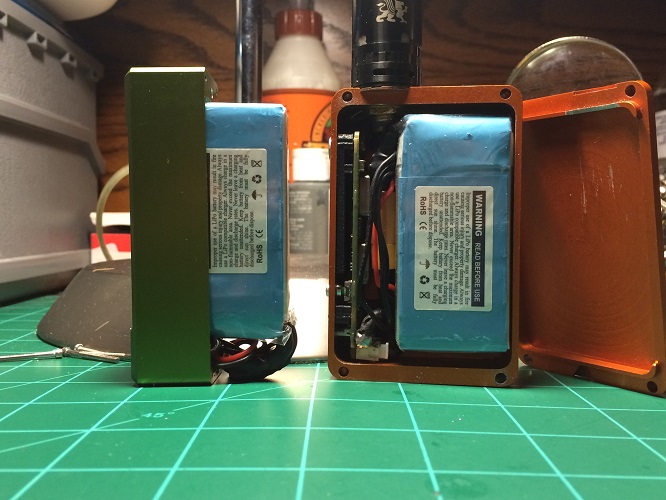

Just built my second DNA 200 in the last 2 days again with ModCrate parts. ModCrate green Silo 1300 box with ModCrate HCP 510, Glacier 1300 lipo. Hats off to ModCrate for there service, shipping and prices. This whole building a DNA box mod is addicting!

How is the Silo's width compared to the 1550P? I see its a little taller and probably has a little more depth.
Posted
Width about the same maybe just a hair thicker. The 1550p+ shorter deeper, Silo taller thinner. I'm leaning to the Silo being my fav but less room to use the XT60 plug on the battery because the 1550 is a little deeper I could use the XT60 plug and run it between the DNA board and the battery. And I had to file a little off the lid lip on the 1550 to clear the 510 nut. I'm sure somebody could get the battery to fit in the Silo with the XT60 plug but I was tired of fiddling with it. LOL!
Posted
Thanks for the pics. I had trouble with my choice of lipo's for my 1550P. It was too thick and the door would not close all the way and wanting to get it up and running I made a pack with two LG HG2's and soldered them direct to the board for usb only charging. I had to desolder the JST plug and re-wire it to charge two cells. What battery is that your using in your 1550P?
Posted
 Glacier 1300 lipo It was a tight fit also and I had to screw the lid shut.
http://www.buddyrc.com/glacier-45c-1300mah-3s-11-1v-lipo-battery.html
I had bought the Turnigy nano tech 1300mah and it was about a mm to thick with the outer wrapper taken off even. I used the plastic safety wrap from the Turnigy for my HG2's as I did not have any shrink wrap large enough for two cells then tapped that on. I am really happy with the battery life I am getting from the LG's. I get a full day out of it if I keep it under 50w.

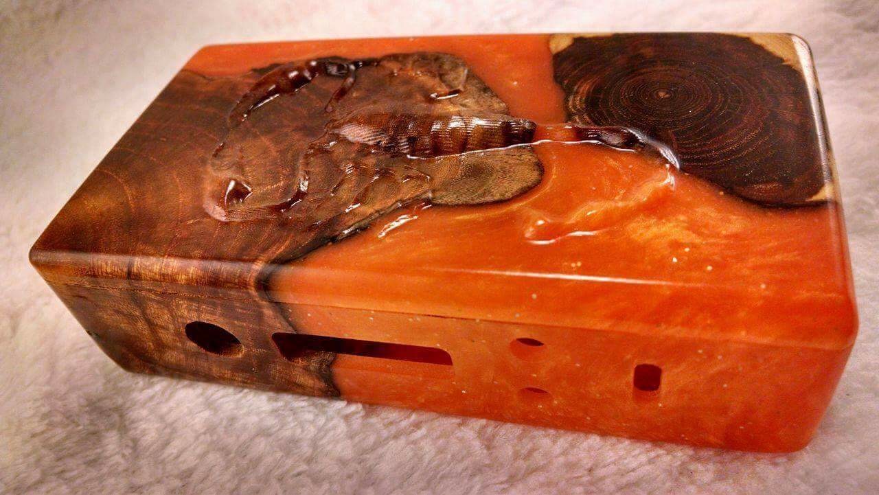

Seen some awesome mods here and couldn't help starting my own, so here's the box. Felt kinda weird not doing one myself (no I didn't do the box, I ain't that artistic and I don't own a cnc, pretty much just laid out what I wanted). Looks like a Lippo 1300 is barely gonna fit...

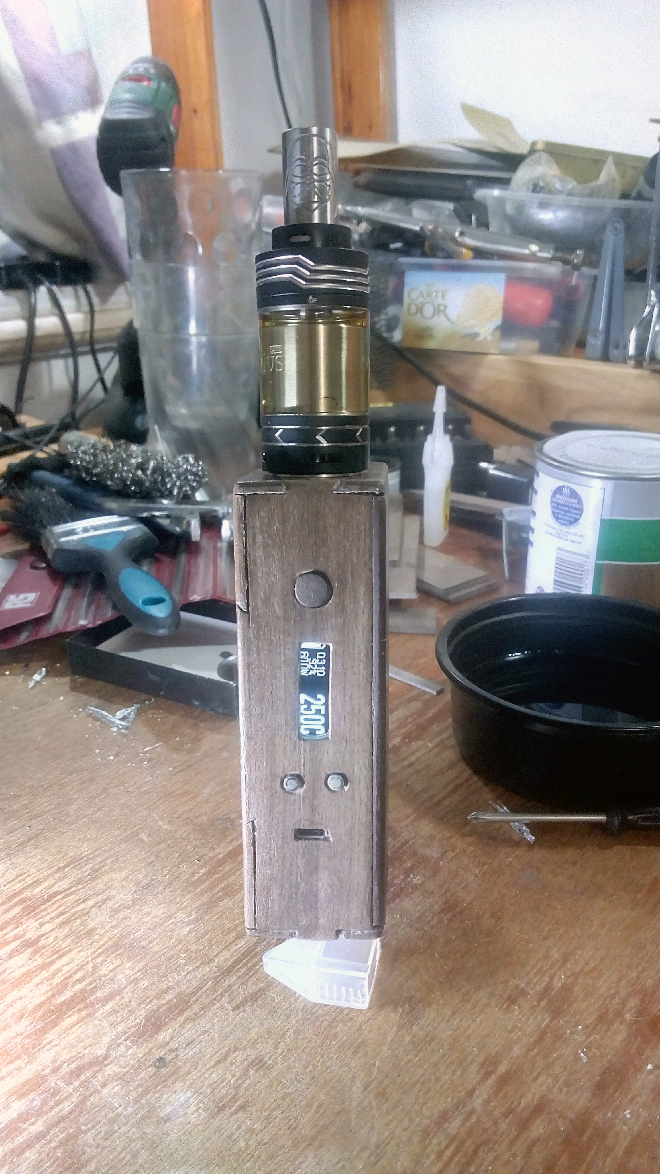

Late to the party but here we go.
Called this Ulysses because I have a particular mod naming strategy to do with eternal champions and it suits since I've had all the parts for building it since January 2016, so it must have been off having protracted adventures.
Decided to resurrect skills I've not used for 20 years or more and build a nice walnut box.  While the final results aren't perfect I think it turned out quite well.  I varnished the wood with matt varnish but still has a slight shine which I shall be dulling down with time and careful chemical work.  You can see various stages of the build in a photo album I have.
Oh and the custom menu pictures are. . .
