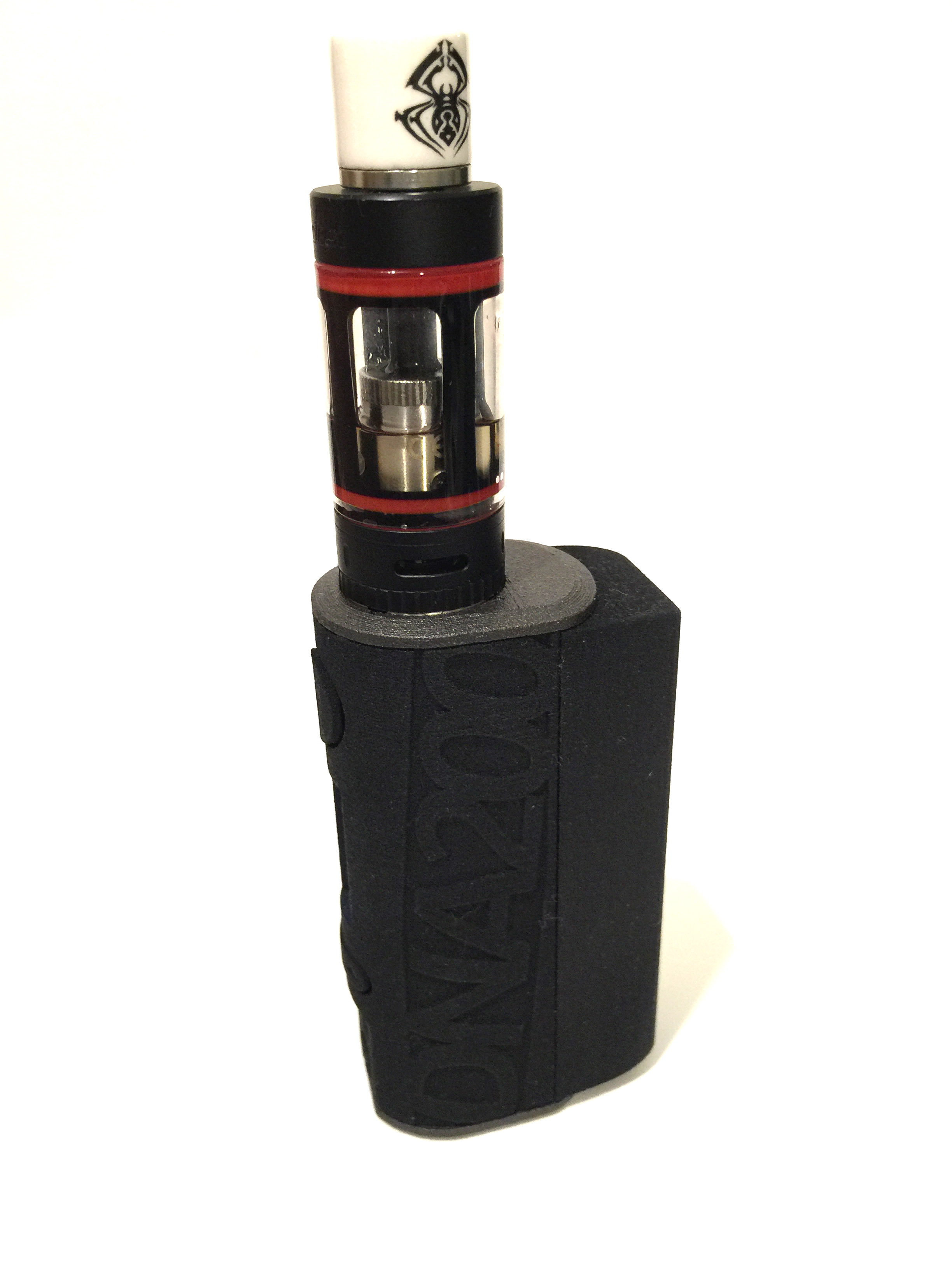

soulseek Posted September 23, 2015 Report Posted September 23, 2015 FireBALL said:here is the final 900mAh DNA200 print with metal top, bottom and black plastic nylon body Could you please post a few other photos from other angles?
FireBALL Posted September 23, 2015 Report Posted September 23, 2015 soulseek said:[QUOTE=FireBALL]here is the final 900mAh DNA200 print with metal top, bottom and black plastic nylon body Could you please post a few other photos from other angles?[/QUOTE]here you go
Polo65 Posted September 24, 2015 Report Posted September 24, 2015 Love the form factor on that beautiful Mod FireBALL
FireBALL Posted September 25, 2015 Report Posted September 25, 2015 Polo65 said:Love the form factor on that beautiful Mod FireBALL Cheers!

FireBALL Posted September 26, 2015 Report Posted September 26, 2015 FireBALL said:[QUOTE=Polo65]Love the form factor on that beautiful Mod FireBALL Cheers![/QUOTE]Here is a link to Shapeways plastic nylon case

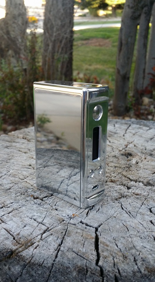

Brady Posted September 26, 2015 Report Posted September 26, 2015 Received our first prototypes of the Evo. This one has a polished finish without engravings, where the production versions will be anodized.
Podunk Steam Posted September 27, 2015 Report Posted September 27, 2015 They didn't do too bad with these. I'm fairly impressed and that doesn't happen easily with me.
Mad Scientist Posted September 27, 2015 Report Posted September 27, 2015 Brady said: Received our first prototypes of the Evo. This one has a polished finish without engravings, where the production versions will be anodized. Is that going to be commercially available? Looks great.
Brady Posted September 28, 2015 Report Posted September 28, 2015 Mad Scientist said:[QUOTE=Brady] Received our first prototypes of the Evo. This one has a polished finish without engravings, where the production versions will be anodized. Is that going to be commercially available? Looks great.[/QUOTE]Yes, you can check out our facebook page or group for updates. Just search for "Psyclone Mods" or "Psyclone Evo". Thank you for the kind words, a lot of time has been spent on the design.
Podunk Steam Posted September 28, 2015 Report Posted September 28, 2015 Will the buttons protrude any more than the prototype? Any photos of the interior? Battery size? I don't do FB and don't have plans to any time soon.I've just realized I was right about my personal feelings for the Lipos, 900 mah doesn't last very long at all. Hope Hot Cig gets the dual 18650 packs out soon or this thing's likely going the way of the Dodos. I've even knocked the cutoff down to 3V. I guess I could bring my ohms up. I'm at .04 according to the DNA200 with a twisted 28 gauge Ni200 wrap on a 3.5mm mandrel, I'm hitting it with 30 watts.
Brady Posted September 28, 2015 Report Posted September 28, 2015 Podunk Steam said:Will the buttons protrude any more than the prototype? Any photos of the interior? Battery size? I don't do FB and don't have plans to any time soon.I've just realized I was right about my personal feelings for the Lipos, 900 mah doesn't last very long at all. Hope Hot Cig gets the dual 18650 packs out soon or this thing's likely going the way of the Dodos. I've even knocked the cutoff down to 3V. I guess I could bring my ohms up. I'm at .04 with a twisted 28 gauge Ni200 wrap on a 3.5mm mandrel. It will be a 1400mah Lipo battery. We also found that the buttons were too recessed, and that has been addressed. Here is a picture of the internals of our anodized prototype.
Podunk Steam Posted September 28, 2015 Report Posted September 28, 2015 Sure looks different than the prototype posted.Edit: Sorry the angle of the photo changed the look.
Brady Posted September 28, 2015 Report Posted September 28, 2015 Podunk Steam said:Sure looks different than the prototype posted. We had 2 prototypes made, one anodized, and one raw aluminum. The internals are from the anodized prototype, as I mentioned .Edit: We also polished the one with the raw finish, that is why it looks so shiny!
Podunk Steam Posted September 28, 2015 Report Posted September 28, 2015 It wasn't the shiny part that looked different, the protrusion top and bottom of the buttons isn't as pronounced in the picture of the anodized mod because of background colors and the size of the photo.
Brady Posted September 28, 2015 Report Posted September 28, 2015 Ah, yeah I see what you mean. It does kind of blend in with the background in that picture.

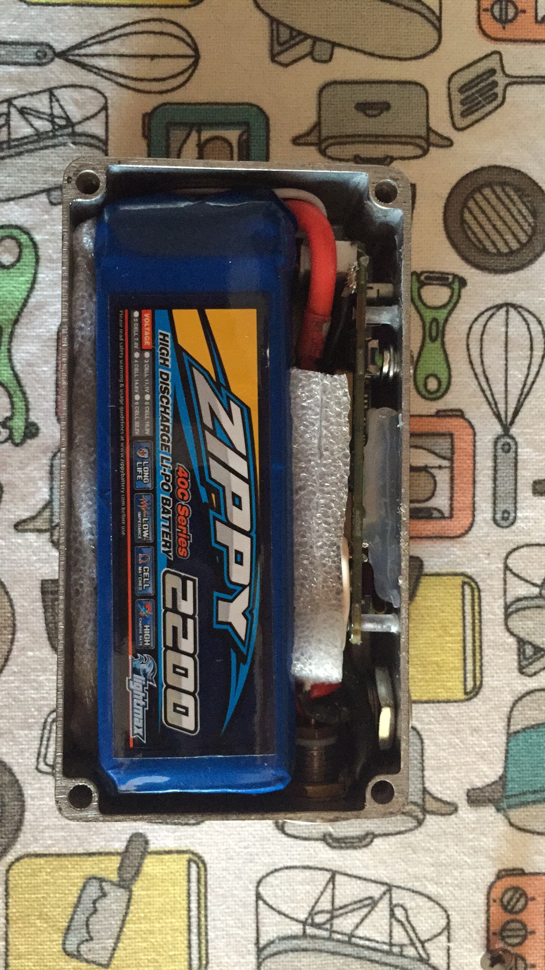

ImmortalVapes Posted September 28, 2015 Report Posted September 28, 2015 Rico said:Hey all,I really enjoyed seeing all your nice creations with this uber chip.Here is mine, not very original but I love using it The case is a 1590G. What did you use to secure the screws in your case. I've tried JB Kwik Weld and 2 part epoxy (el-cheepo from Hobby Lobby) but the screws break off when I try to get the board in after soldering the 510. The epoxy breaks at the case and the JB weld tends to crack around the screw head. I'm even using the same buttons. It's put together but the battery holds the chip in place.Your screws look more robust too. I used 1/2" 0-80's with flat heads for good surface contact. My phone is a potato. I'm going to resolder the 510 at the + to get a little more room at the top and the - at the board to clean it up a bit.
Podunk Steam Posted September 28, 2015 Report Posted September 28, 2015 You might try texturing the the area around the screws and using JB Weld, the JB Kwik isn't what the JB Weld is.Edit: If you want to get real serious with it this stuff's got band-aide beat. This is not the same Plastic Steel as found in the tubes, the tubes I wouldn't bother with.
Mad Scientist Posted September 28, 2015 Report Posted September 28, 2015 As another idea, increase the surface area of the head of the screws. Solder or silver solder the screws to thin pieces of steel as a "sled" then use the preferred adhesive on the steel to mount in the box.
