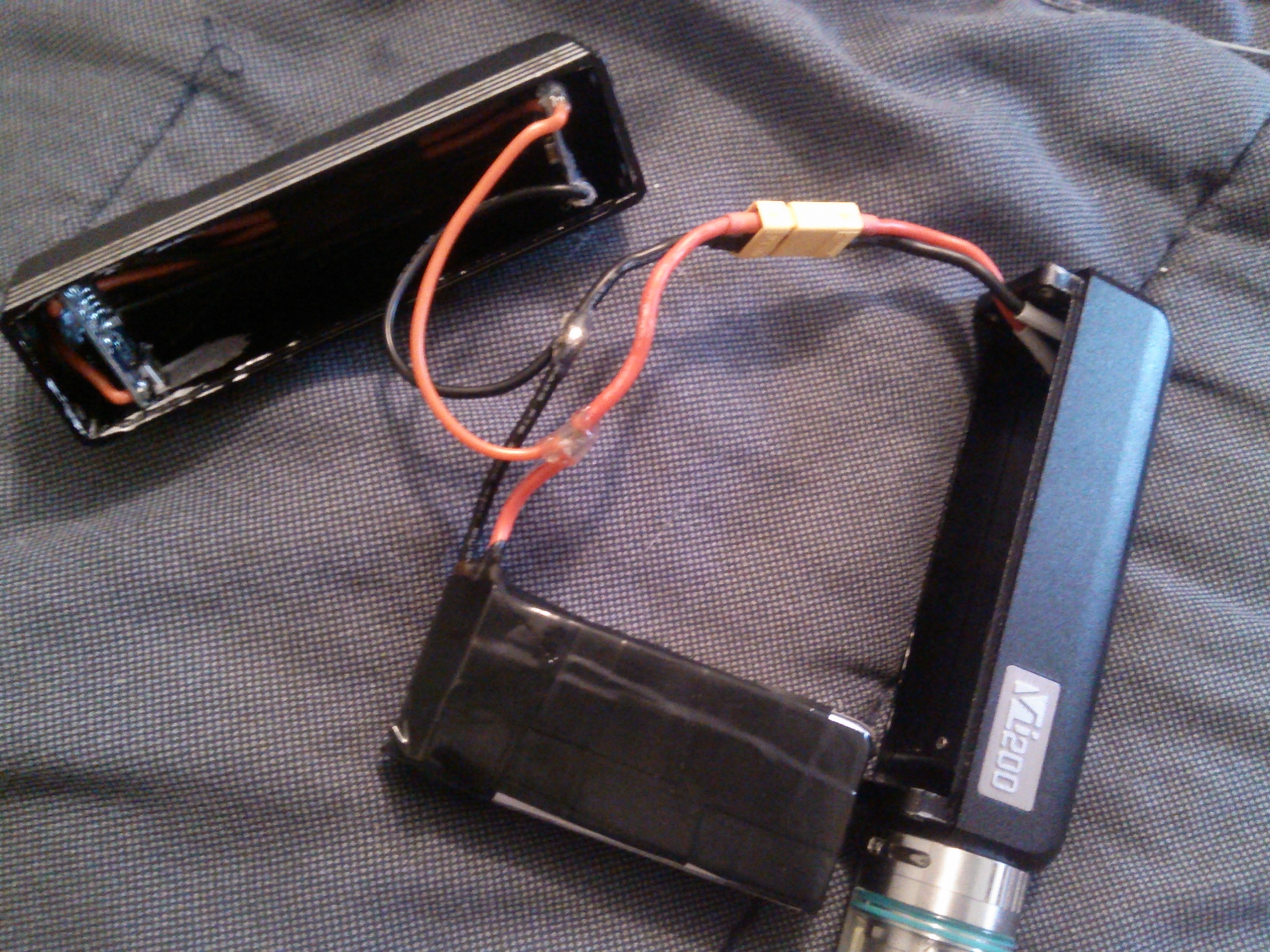

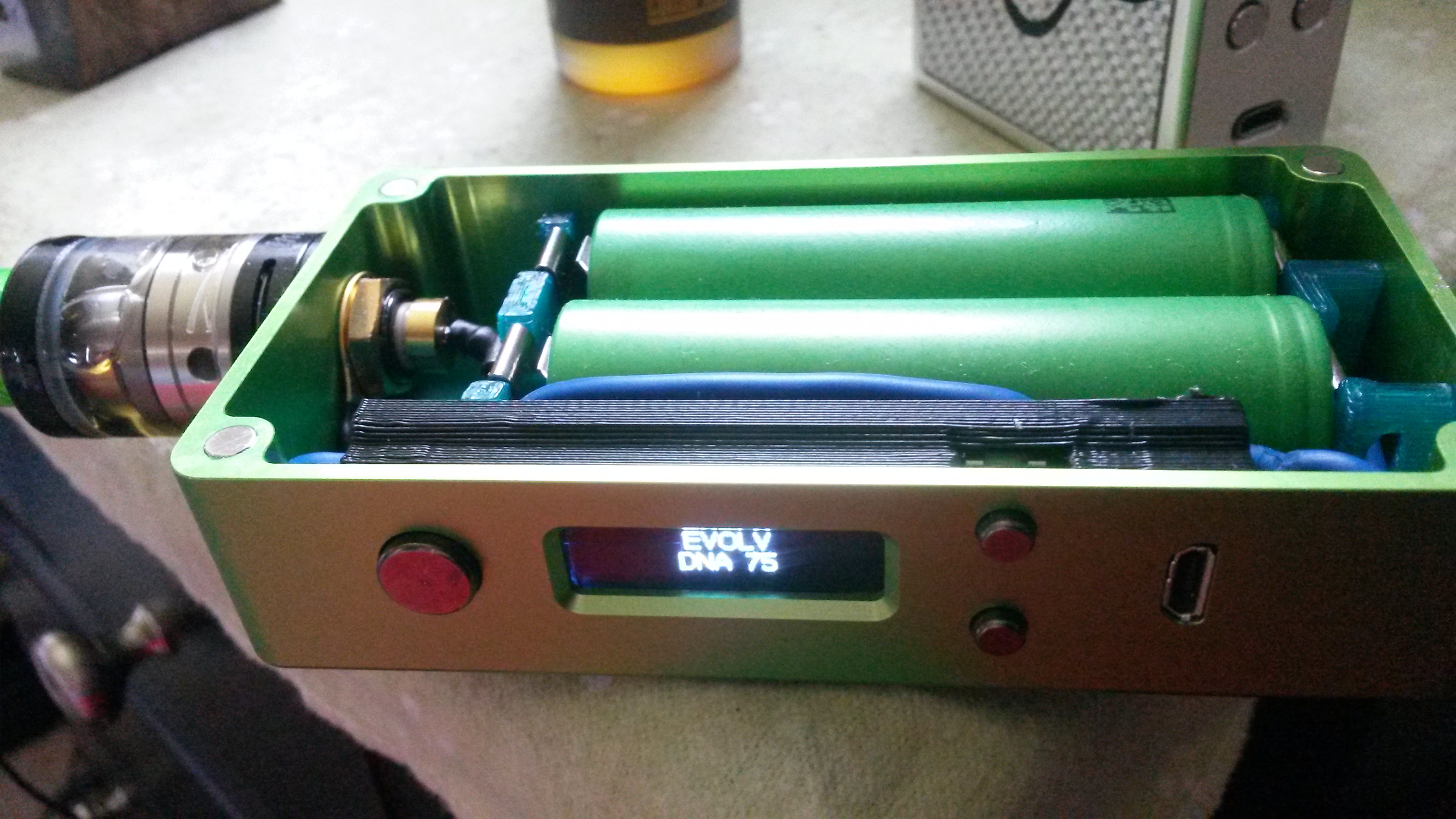

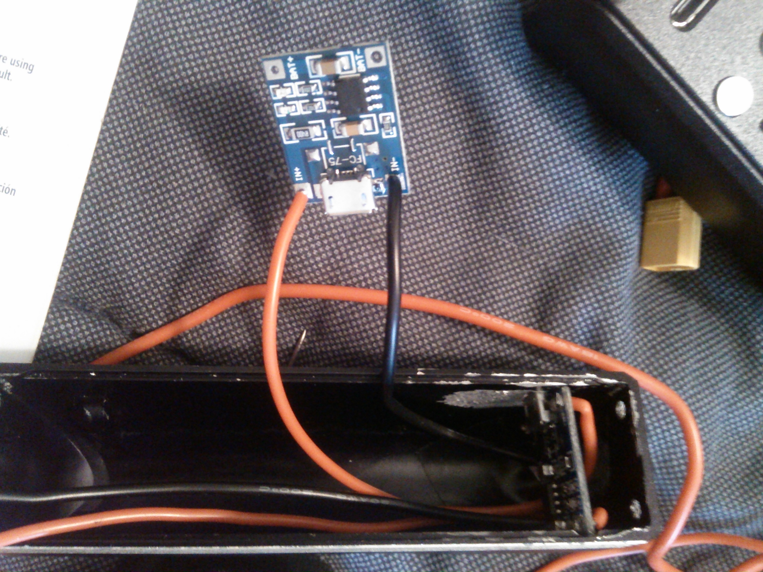

Spector NS5 RD Posted May 26, 2016 Report Posted May 26, 2016 nice, an official dna 75 build thread. thanks dwcraig1! i hacked open a dead vt200. sent the dead board to evolv for replacement. rather than putting the replacement board back in i decided to put the 75 board inside. modifications required to install board are : chop off plastic oled screen stand offs (dna75 board components get in the way of it sitting flush), rewired/re-soldered stock 1300 mah 3s lipo for 1s 3p config (2898 mah according to battery analyzer). i'm bypassing the onboard usb charging ic for a higher (2) amp combo i put together. i dremeled/installed the usb socket on the side of the mod (limited space for it). my dremel skills are.........not great. that's about it. really enjoyed building this. plenty of current available to the board with this batt and the 3p lipo charges fast at 2 amps. 2

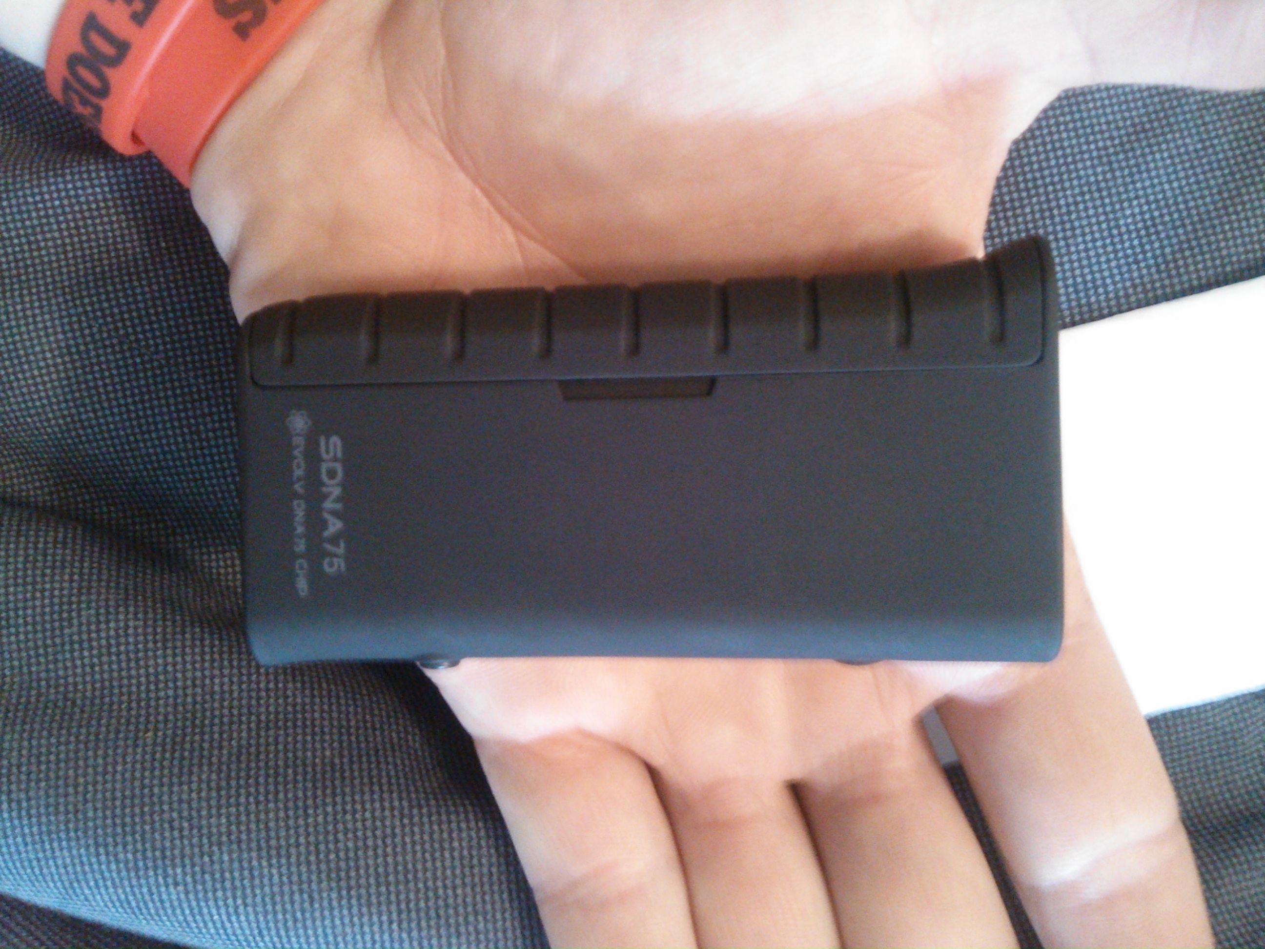

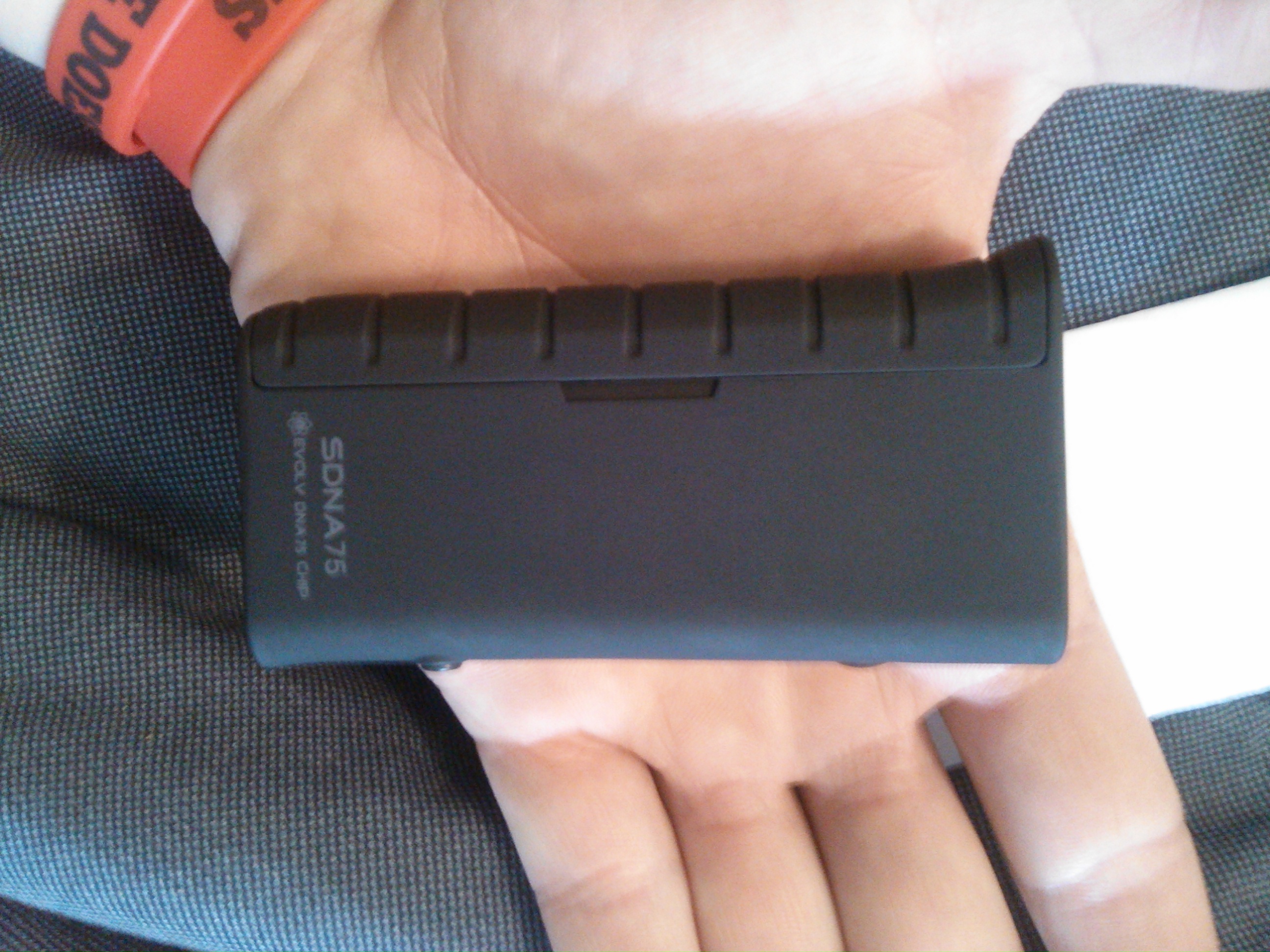

Spector NS5 RD Posted June 11, 2016 Report Posted June 11, 2016 man is this thing tiny. the black finish feels just like a VS. i'm willing to bet this finish will hold up better though. my screen is a hair crooked. not a prob, can be fixed easily. 3.5v sag on 75 watt preheat at 11 punch and 1.5 seconds. that is on my recently purchased, freshly charged LG HD2C batts. battery sled contacts are VERY tight. no weak battery message yet. 25mm tanks do overhang on three sides. came all set up - mod res, case thermals, wires and on this mod the profiles are used as different ramp ups. the included usb cable is a puny 9" lol. nice mod all around for $66.

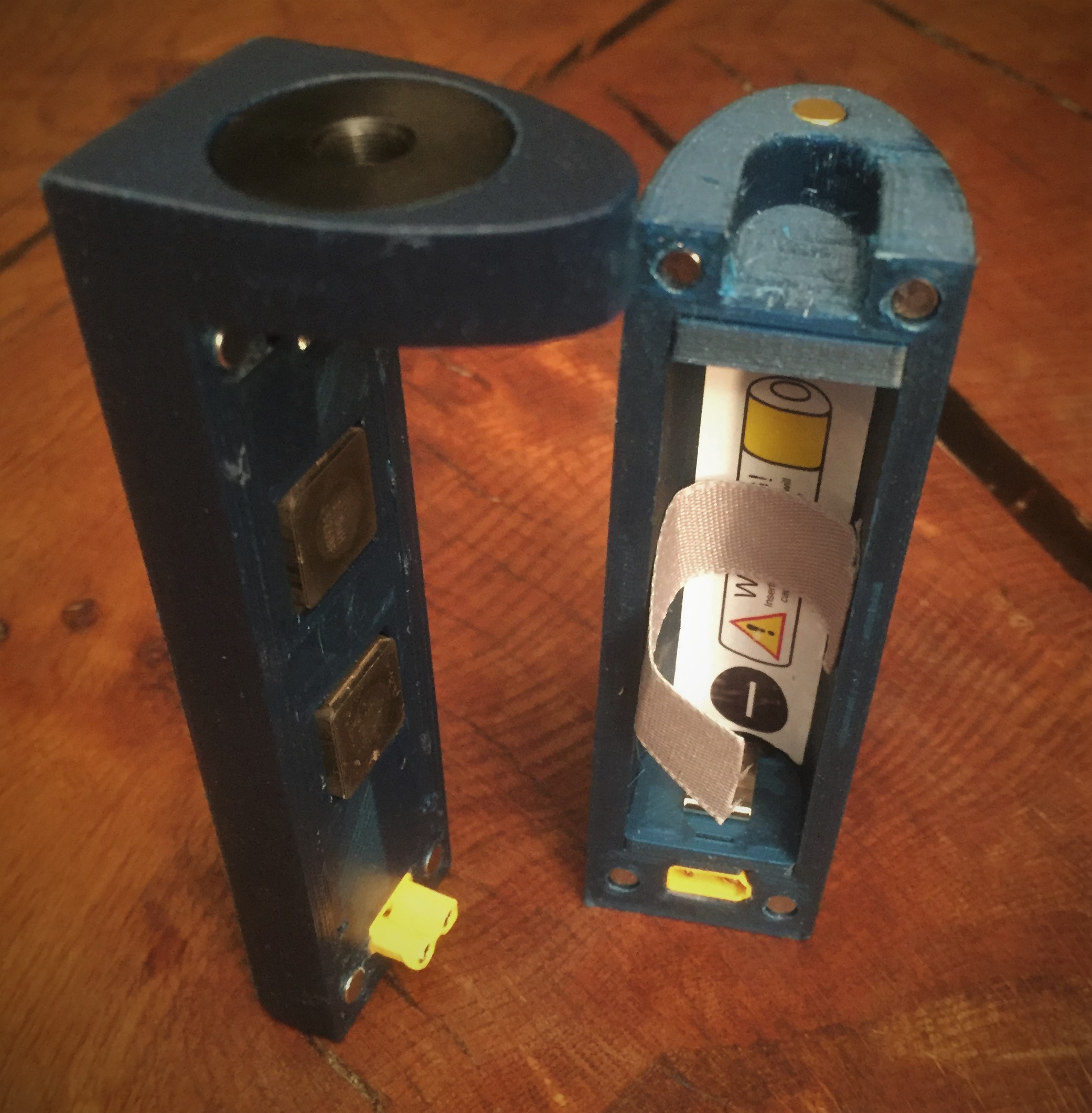

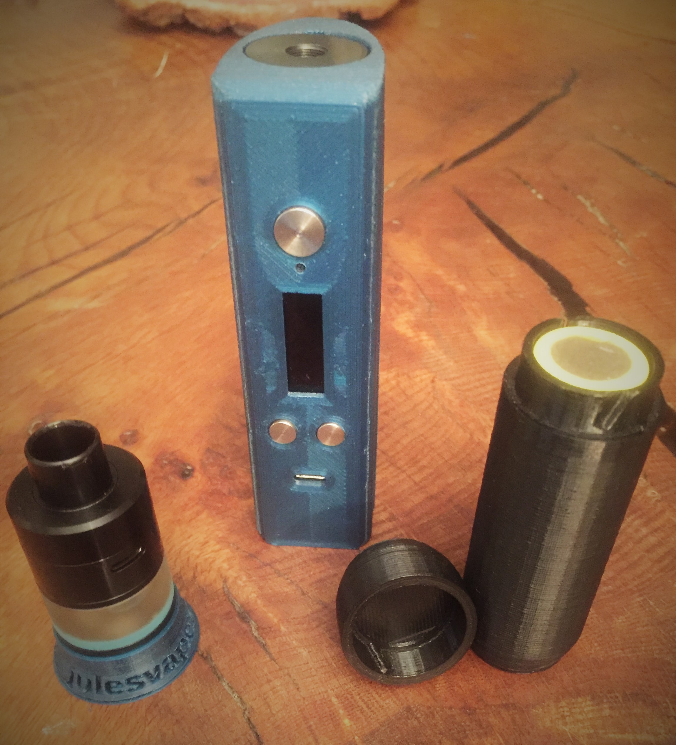

lewisss Posted June 12, 2016 Report Posted June 12, 2016 Here's mine with a matching atty stand and spare 18650 case
soulseek Posted June 13, 2016 Report Posted June 13, 2016 lewisss said: Here's mine with a matching atty stand and spare 18650 case Expand Really like the case. Where did you get it printed?

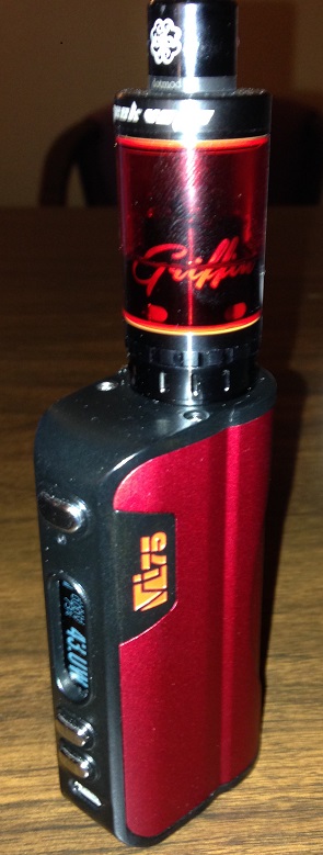

SF0059 Posted June 13, 2016 Report Posted June 13, 2016 VT75. Nothing fancy, but I love it. Will get a wrap for it soon...

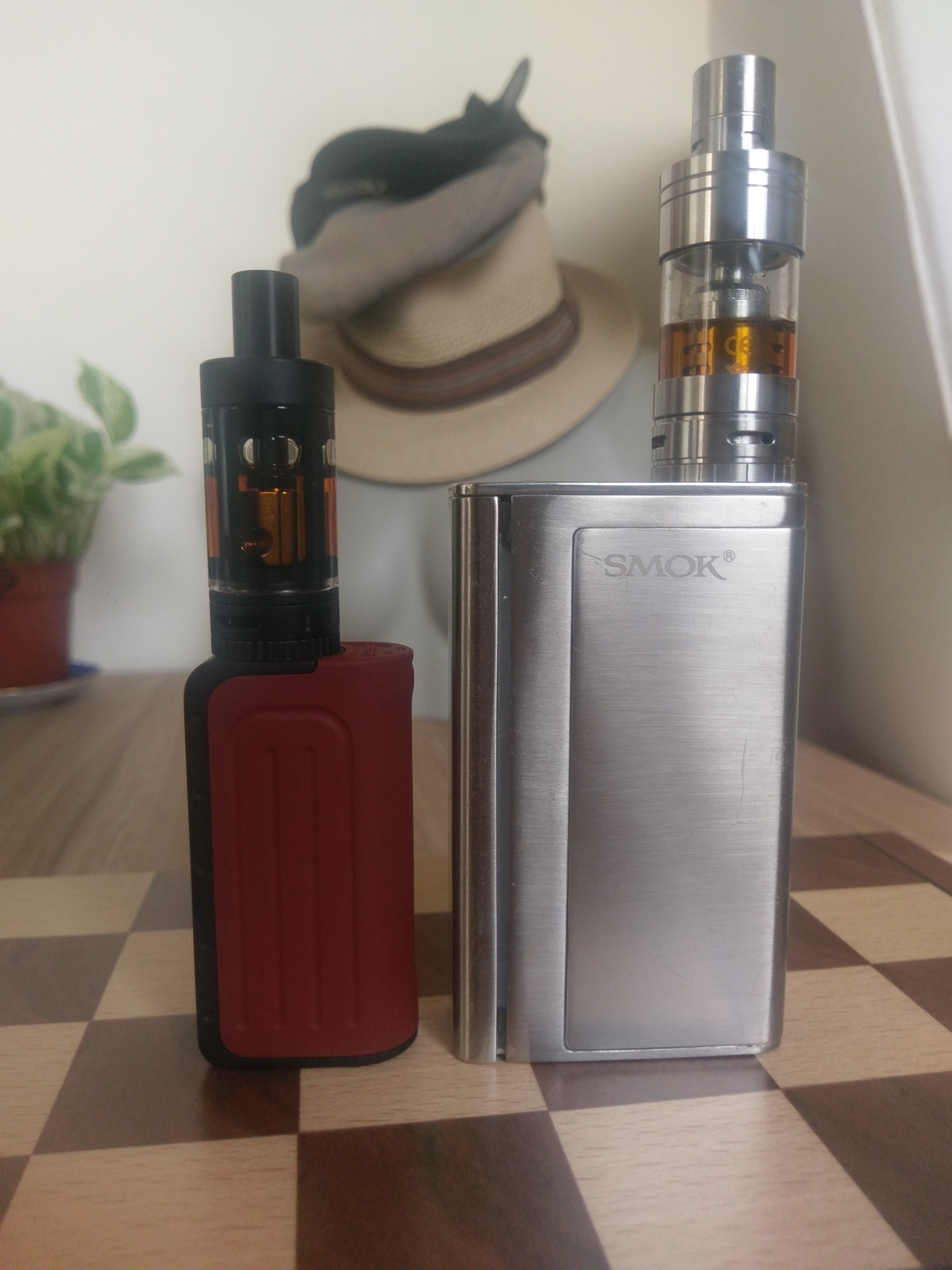

smallcaps Posted June 14, 2016 Report Posted June 14, 2016 Hi all. First time posting. Picked myself up an Elfin DNA 75 and loving it so far. Quite a change lugging around my Smok Cube ll. Googled DNA 75 and found this wonderful place. Now I want to build my own!
