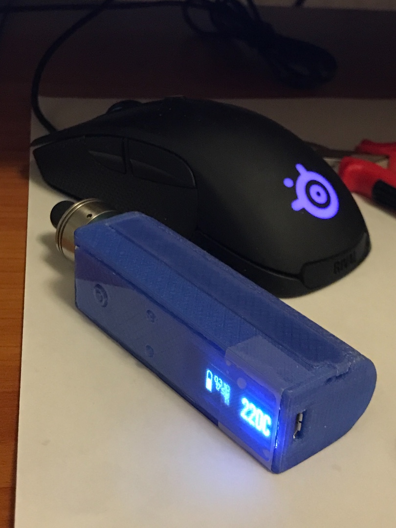

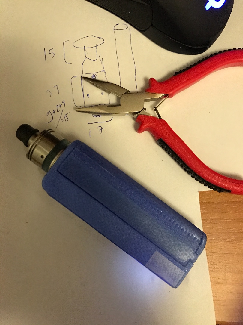

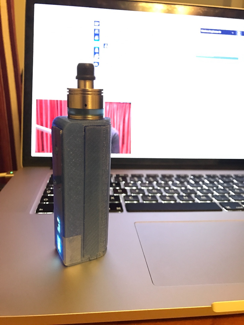

soulseek Posted February 7, 2017 Report Posted February 7, 2017 So I've put the DNA60 in a 3D printed case that I made myself. It's the first iteration so I'm going to make improvements to it. It hasn't been polished yet and the front panel is taped because I haven't had time to place the magnets. Otherwise it works perfectly, it's very light and small. 1
