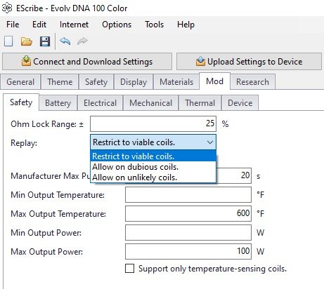

I don't mean to sound insensitive or anything. But if you want to use TC, SS904L is one of the worst materials out there. Since it barely changes resistance anyway while heating up compared to other SS alloys. Thus it is going to be frustrating even for the best of us. And your atty must have really solid connections if you want to use something like SS904L with TC. And some attys are well known for having stability problems with TC. Some manufactures even sandblast their 510 threads, which is a huge no-no for TC. You're using a Zeus X right? I have a few of them. But I never tried TC with them. Maybe I'll experiment a little and see how stable they are. -

Is it still set on unlikely coils? -

http://www.steam-engine.org/wirewiz Shows the TFR of SS316L and SS904L have very similar curves. Except SS904L changes resistance much less. The TCR of SS316L shows 0.000879 while SS904L shows 0.000734. Hopefully @Darth vapes has the right material selected. -
