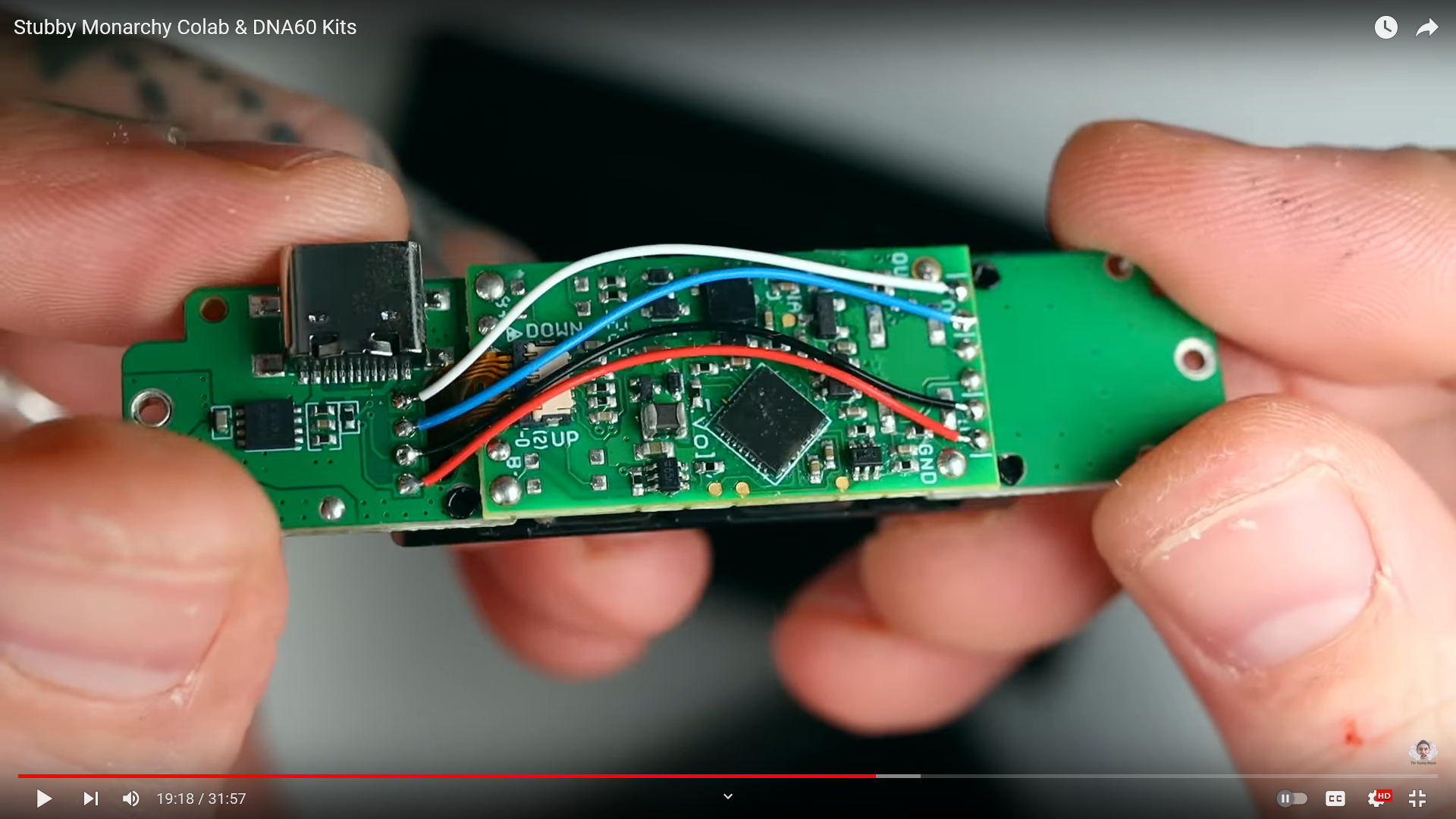

	It should connect to EScribe by the board alone without being installed in the Stubby too. There are four wires between the Stubby board to the DNA60 board that controls data. And something is wrong there if EScribe still can't connect by the board alone. I have two of those boards and mine hasn't been unboxed yet. But Wayneo is right, the place you got it at is the place to go. Although Evolv by filing with the HELP DESK is another option to try if the first option fails. I think I would check those wires first. If ok, maybe they wired them to the wrong place, like getting two wires reversed.

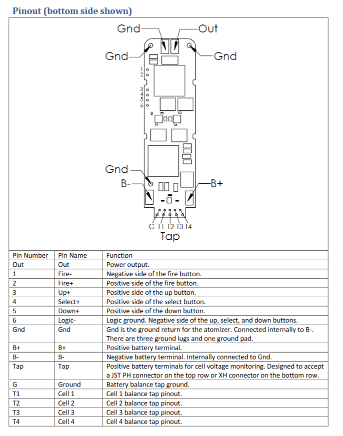

	One connection to the switch is neg or ground (same thing). The pos switch connection is normally not ground unless the button is pressed. Thus if pressed, the pos becomes the same potential as ground. Now the chip sees the button is pressed. Virtually all digital switches work this way including keyboards.
