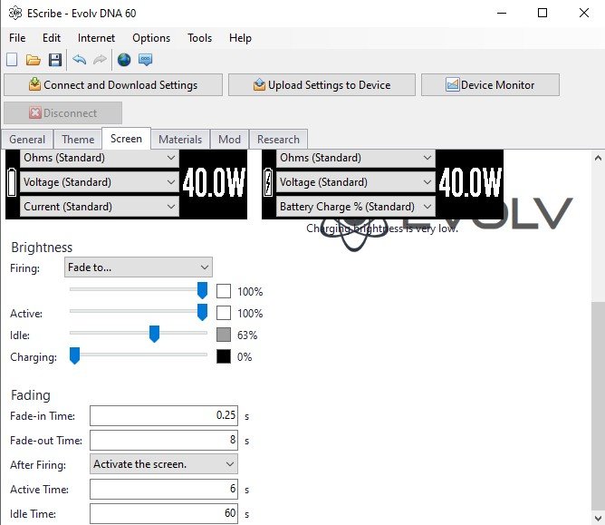

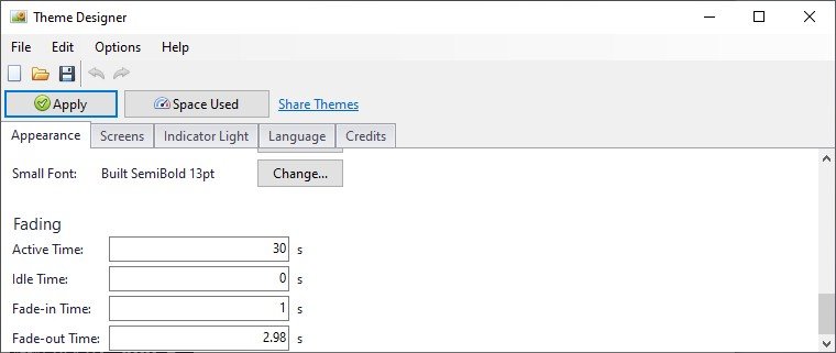

Where did the Screen Fade go?!
BillW50 replied to gremlinn's topic in EScribe, Software and Firmware
If you are talking about the non-color board, it never has been in the theme, but here. Both examples are from EScribe SP30.3. -
