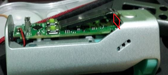

	  Reuleaux DNA 200 Screen Ribbon Fix Yes/NoVapingBad replied to Teehippster57's topic in DNA 200 and 250 Does this actually fix the problem though? The problem isnt the button touching the cable, its the button pushing on the cable and making the cable move. If your plastic shim still gets hit by the button and causes the cable to move, you'll have the same problem. Ribbon cables are not made to constantly be flexing around, the wires inside are very very fine and constant movement is what causes them to break.[/QUOTE] Yes, the plastic stays put and acts as a barrier between the cable and button so both possible modes of failure are averted, 1 the cable getting pinched between the button and switch and 2 abrasion of the cable by the switch.

	Try and return it under warranty and be clear that it is a manufacturing problem, it has been well known since before they introduced that mod the cable should be kept clear of the fire button. In EScribe - Help - About EScribe click the logo 7 times then go to Device Monitor and look at the Screen Disconnect value if I'm right it will be greater than zero.
	Sounds like they let the screen cable get under the fire button, a definite manufacturing fault by Vapecig and it will need a new screen, unfortunately they are in short supply via retail outlets ATM though manufactures may well have stock for repairs.

	  Reuleaux DNA 200 Screen Ribbon Fix Yes/NoVapingBad replied to Teehippster57's topic in DNA 200 and 250 Why risk taking your screen out and putting more folds in it , as I said earlier just put a bit of plastic between the cable and the button, I just got a Reuleuax today I did some pics. I gently worked the plastic in between the wire and the switch from the direction of the arrow then trimmed the excess off.

	  Reuleaux DNA 200 Screen Ribbon Fix Yes/NoVapingBad replied to Teehippster57's topic in DNA 200 and 250 IMO the fix shouldn't need removing the screen, I can't be 100% as my Reuleaux is still in the postal system, but from the pictures you could just put a thin bit of plastic between the button and the screen cable, perpendicular to the board, maybe attached to the dark outer housing.
