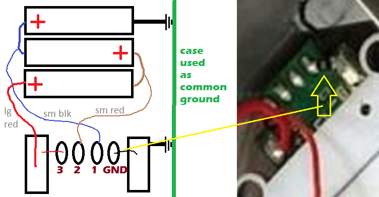

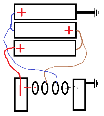

Using only 2 balance wires is not that bad, IIRC Evolv recommend keeping them the same length, but they form the same circuit and provide the same inputs to the board so it is no biggie. I only posted to give a possible explanation of how it could be wired with 2 thin and one thick wire. The pics are all consistent with my picture and the board does have a ground screw.
So it is just using the center 2 taps, thanks dwcraig I had just ladled the picture to try and help jaquith, did you measure the thicker wire conductor diameter?
They are not "negative" Jaquith, well the lowest one is, but the other taps are at the voltages between the cells so the outside 2 are the same voltage as the main battery leads. So for a balanced 3S @ 12 V they would be: 0 V, 4 V, 8 V & 12 V and each adjacent pair would be 4 V the cell voltage. Edit I just noticed the numbers you added, but they are still not negative except the lowest one, or maybe you mean the negative terminal on the cell again these points also contact the positive of the lower cell in the series.
draw me up a diagram kid. im pickin up what yer layin down, but a diagram would make my night. thanks.[/QUOTE] Not very good, just lashed up in M$paint This is not a recommendation, but it could be how the Reueaux is wired, just saying don't shot the messenger.[/QUOTE] In your 'drawing' you'd take the 3rd negative off your 'ground.' [/QUOTE] I don't follow there are only 2 negatives the negative pad which is shown grounded and the negative balance connection shown connected to the negative pad. No extra wiring needed to complete the circuits all 4 balance connections are connected.
Escribe takes the settings from the device, so no mater how many you plug in Escribe will not mix them up. You can load settings, profiles, themes etc from a file after you attach the device then save them to the device if you want to copy from one device to another, just be carfull not to copy the mod settings (res, thermals & battery).
It only needs 2 balance wires, 4 is better but if they take 0 & 3 from the battery pads, need better photos, but you would expect to see a thin wire from each battery pad to the nearest balance pad and the 2 centre balance pads connected to the battery cradle. I suspect that is what they have done plus taking the negative from the cradle to one of the screw points and common grounding to the chassis, but it is all conjecture from the photos.
As Flavoured pointed out on ECF the negative should be from the other end of the battery pack, maybe they are using the chassis.
If you look carefully the b- wire is not the same as the b+.. They're using the same wire for b- as they are for balancing..[/QUOTE] I thought that they had disconnected the main -ve wire, but as you say the pics on photobucket show some skinnier wire for the -ve while the battery tray is being removed.
