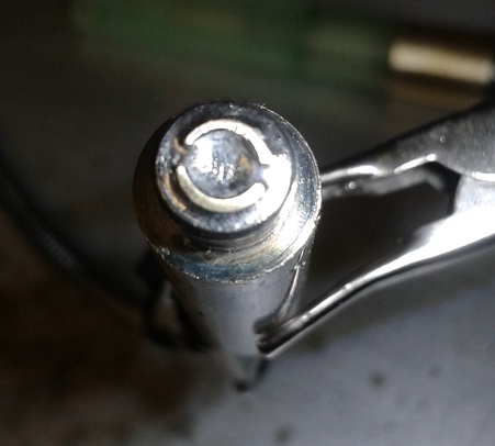

  3. Maybe, but the power wires are a little under spec and the ground tab from the battery cradle is not very substantial and will limit the effect of tweaking the springs. It probably won't be a big deal unless you are at very high watts and I would just make sure it works well with your batteries and leave it at that. When I say works well there have been some where the positive reverse protection plastic moulding is a bit big for the battery and they don't make a good contact, just one of those things 18650 are not precision instruments. You could reduce the ring a little or use small disc magnet on battery +ve if you get this.

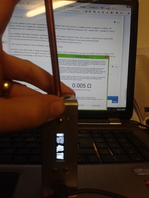

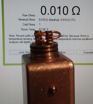

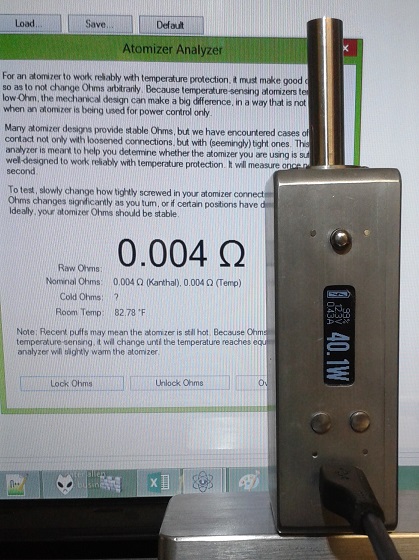

  10. I see you have a mod res test with a veloicty reading 0.013, if you set your mod res anywhere that it could be at least part of the problem. I tested my 1590A mod with a varitube like that and got 0.010, but with a solid copper bar I got 0.005 and a soldered carto 0.004, I set it to 0.003.

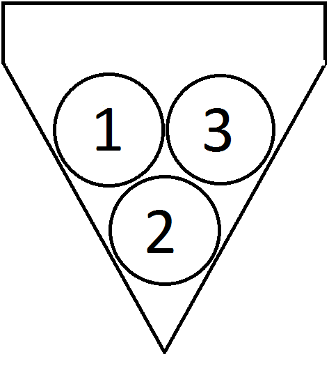

  14. That was an example of a bad connection to a cell, before deciding if one cell is bad swap thier positions and see if the weak cell is still the same physical cell (18650) or same position ("Cell n" in Escribe). Cell numbers for realeaux from above
  15. You should look at both plots, with the cells swapped around cell 1 is still weak, so most likely is that battery slot as I said above, the OP understands anyway.

  19. The red line is still a little lower, which probably means a weaker connection on that cell which could be the plastic ring on the positive connection in the mod battery cradle is a little high and struggles to make a good connection with all batteries. If you put a thin disc magnet on the +ve of that battery and cures it than you could do 1 of 3 things: use it with the magnet, sand/cut off a little of the plastic ring or return it for replacement. It could also be soldering to the balance connections if the magnet does not fix it.
  20. From the photos I think these are the cell numbers when looking from above.
  21. If you swap the a battery positions and cell 1 is still the weak one in Escribe then it is a problem with the mod.
  22. You can see the battery voltage take a dive (dark red line) on you plot, it is probably a poor connection, try a disc magnet on the +ve of the outside battery. E: I mean the rear lhs battery no the outside one.
  23. Cell 1 is the one that is causing the problem, I think that is the rear lhs battery, not absolutely sure though.
  24. Because you have a high voltage sag from the batteries. 18650s will never perform as well as decent LiPos, but it could be old, tired or low CDR batteries, poor or dirty connections, poor soldering and a few other things. What batteries are you using? First try cleaning the battery terminals on the batteries and mod with IPA or rubbing alcohol, I also read that for some batteries the reverse protection ring is a little high and can cause a poor contact, a small disc magnet on the positive terminal should confirm this.
