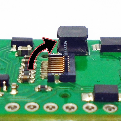

Reuleaux DNA 200 Screen Ribbon Fix Yes/No
VapingBad replied to Teehippster57's topic in DNA 200 and 250
If you are going to bend the screen cable it will be a lot easier and IMO safer to disconnect the cable from the board by flipping the plug clip up and make one fold at a time rather than the 3 at one time doing it in-place. They are not fragile when done like this as long as you don't bend it right by the screen and don't bend it repeatedly in the same place. Ceramic tweezers or a wood tooth-pick in the hole on the cable are good to insert it back into the plug, take it slowly and don't force anything. Though I still think the piece of plastic method I posted before is less risky if you are new to this. How the zif socket opens, be very gentle with this, the cable comes in from the rhs of the picture.
