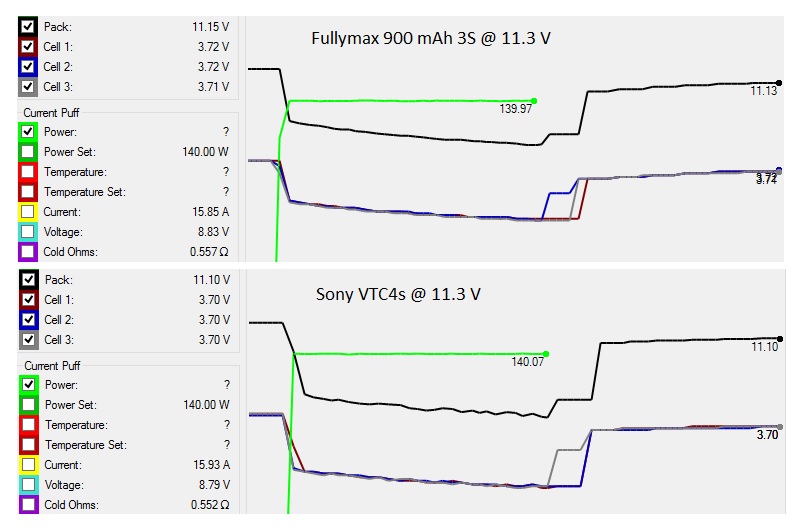

  3. Also consider the much larger capacity of 3 2500 mAh 18650s should work in there favour, being 2.75 times that of the LiPo I used and the current capability of an equivalent capacity LiPo would be 2.75 times.
  4. Only 140 W as the coil I had handy for the battery analyser was 0.557 ohm and the power limit for that is about 145 W, I'm sure it would look even more dramatic if I used a higher power and newer LiPo let alone a 90C LiPo. Same charge level, same fire duration 5 seconds, same coil, though the LiPo has had a lot more charge cycles that the VTCs, the LiPo is only a 30C rating 900 mAh.

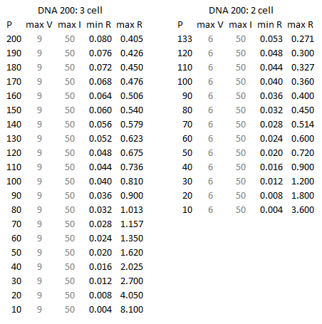

  9. The resistance does not directly dictate the power rating, it is the max & min output voltage & current and resistance that do. You may know, but think watts on both sides of the board with a <=3% conversion loss, at 200 W output the board needs a fraction above 206 W from the battery, at min voltage (9 V) that is 22.89 A regardless of the output voltage, current or coil resistance. The max output voltage is 9 V, current 50 A so both a 0.2 ? & a 0.4 ? resistance would still need 206 W from the battery at 200 W. Ultra low res takes it over the output current limit (50 A) A 0.05 ? resistance at 200 W would need 63.25 A for 200 W which is over the current limit, but only need 3.16 V well within the voltage limit. Higher res takes it over the output voltage limit (9 V) A 0.5 ? resistance would need 10 V for 200 W which is over the max voltage limit, but would only need 20 A well within the current limit.

  16. It is not showing the battery icon either, check it is not set to power supply as battery type in Escribe, I don't if a blow fuse would cause that.

  20. Not sure, the 133 W power limit is well known, but the 6 V output limit is not and will lower the max resistance level VxV/P, it should not effect the low res limit as that comes from the max current limit. Maybe Higher coil resistances limit the max power with two cells or Max resistance is lower for two battery cell operation The DNA 200 is a step down converter designed to run from 3 Li cells is series and is limited to a max output voltage of 9 V. After multiple user requests in this forum Evolv released firmware that allowed it to operate from 2 series cells at reduced power (133 W). The max output voltage has also changed to 6 V for 2 series cell implementations. So you need a resistance between 0.0532 ohm and 0.27 ohm for 133 W (max power) in this mode. The max resistance can be calculated by voltages squared divided by power, the max voltage is 6 V so 36/power will give you your max res a any supported power level. No doubt my pros could be improved, not my strong suit.

  24. This has not been confirmed, but I am 99% sure it it your issue: the DNA 200 is a step down converter designed to run from 3 Li cells is series and is limited to a max output voltage of 9 V. After multiple user requests in this forum Evolv released firmware that allowed it to operate from 2 series cells at reduced power (133 W). It is the input voltage that has changed and it does not step up voltage the max output voltage has also changed to 6 V for 2 series cell implementations. So you need a resistance between 0.0532 ohm and 0.27 ohm for 133 W (max power) in this mode. You want 75 W in 2 cell the max res = 0.48 ohm, in 3 cell = 1.08 ohm V squared over power
