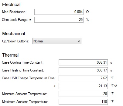

  4. These are the case settings I use
  5. You have had some bad luck there to be sure. Just on the subject of mod res I'm guessing the board mount screws are not tight enough on yours, I would just open it and give them a tweak (don't over tighten them) and you mod res should then read 0.003-0.004. The 510 thread issue is a bigger problem you would need the outer part of the 510 swapped or re-tapped, sorry not much help if you don't have the tools.
  6. Yes, that is good advice and what I do for mods reading a stable 0.004, I'm assuming the one here alternating between 0.004 & 0.005 is about 0.0045.

  9. I would use the lower value 0.004 as if to high it can affect the temp sensing stability.
