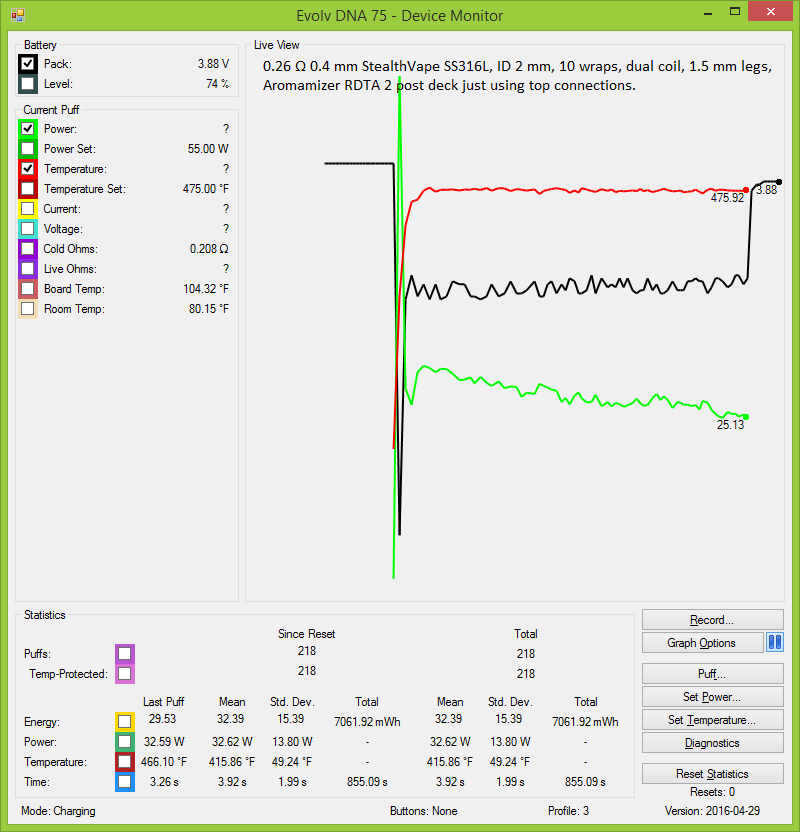

I was thinking LiPo and dual 18650 for the more power hungry. I think that is just the min efficiency and it is probably a lot higher in many parts of the range, it certainly doesn't feel like a battery eater in daily use. BTW the soft cut-off is set to 2.75 V in EScribe, I was just guestimating from dm plot before.
So the DNA 40 still beats the DNA 75 in higher ohm builds
VapingBad replied to VapingModeration's topic in DNA 75
I was discussed, but it would have costs in other areas like the min resistance, I have ran builds as low as 0.03 ohm on it, they work fine, but that is a bit too current hungry for the keystone battery sled, 0.05 ohm runs very well. I think one thing that was difficult with the 40 was the min res restricted what you could build with Ni too much and I for one am really glad they did it this way. -
As you say there is no way for it to match the 97% efficiency of the 200 step down conversion the spec sheet has the efficiency at 85%, but I get good run time from it considering. Not sure what the cut off is off hand, maybe 2.5, 2.6 V under load. There is no such thing as a free lunch and 18650 only have so much usable power, but they are not the only battery option although they will probably be the most popular.
You don't need one, they will make the battery gauge more accurate, but your device runs just as well with the default curve.
Not major, it is very similar to the 200 to operate, but I doubt it would suit you at those wattages. 75 W is a lot from a single cell, it dies a great job at getting the best from the battery, run time is good IMO. But if you are running 75 W preheat like I do at the lower end of the battery voltage that will throttle back because the sag from an 18650 and the run of the mill keystone battery sled we have in the beta units. LiPos would will perform better in that respect and better battery contacts would also help. I am just changing the battery now, it's a 25R and I got a good vape all the way down to 3.25 V, longer drags toward the end as the preheat was not as powerful. Obviously if you were using in power mode it would totally depend on when you battery sage hit the threshold under load, that's just the physics of batteries. They will continue to optimise this so don't take what I wrote as set in stone.
