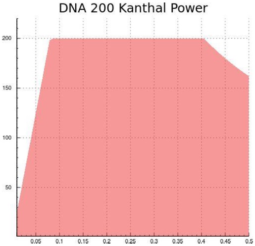

  18. Opps I don't know how I put current limit that is the low end of res, it is the voltage limit at the high end and 0.4 ? is the max for 200 W in the spec sheet. So as some of the resistances are outside the spec for full power I imagine it is just sag, try it again with 0.3 ?.

  20. Is the resistance near 0.18 ?, I'm just thinking that a small variation in the resistance reading of each mod could cause the 50 A output current limit to kick in before the output voltage limit.
