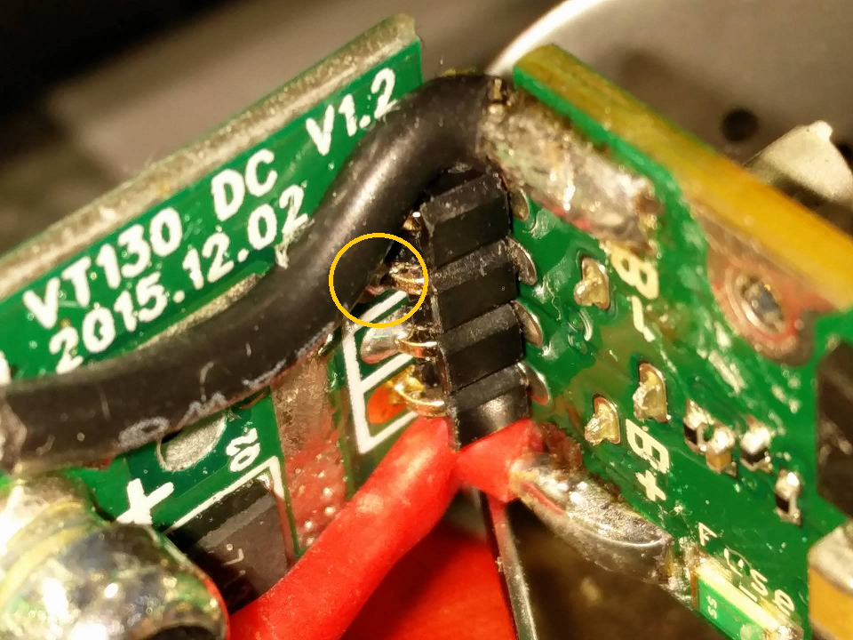

  5. I don't think the soldering is the issue, maybe it's not the best, but it doesn't look dry and is a lot better than some I've seen in commercial mods. The ground pads often come like that and I happen to know where Steamer got his boards from and he has made at least 8 other working DNA 200s.

  8. I would guess that the screen cable has got between the button actuator and the switch and shorting/breaking some of the data lines in the cable.

  12. The voltages on the balance connector pins on the DNA side not the main ones, they are very sensitive to resistance like a dry joint as they are very low current connections.

  14. This looks like a dry solder joint to me and fits the symptoms.
