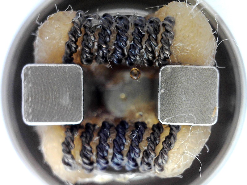

RDA retaining heat possible source of base resistance climbing?
VapingBad replied to 3DClouds's topic in DNA 200 and 250
It is, I flattened the faces of the grub screws and removed the ridge in the post holes on some of my Aromamizer decks for using with twisted 2 and 2.5 mm wires. 3D clouds I find twisted Ti works very well, even the cheap FT stuff. I like this: 2 strands of 0.2 mm twisted cw, then 2 of those twisted ccw, so 4 strands in total, res is around 0.13 ohm and they vape well on DNA 40s (lower the temp 90 F), 75s & 200s.
