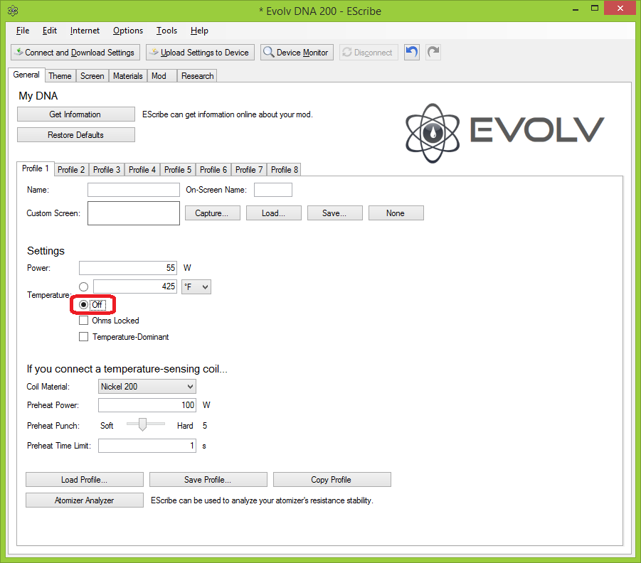

DNA 200 are great in power mode, they automatically go into power mode when they detect non temp sensing wire so what you describe is probably just the other mods putting out lower power than the screen says causing you to up the power on the DNA, jut turn the power down a bit. You can force power mode by adjusting the temp above 600 F if that make you more comfortable, but it is not necessary, this applies to the DNA 25, 40, 75 & 200. You can also turn temp limiting off in each profile in EScribe.

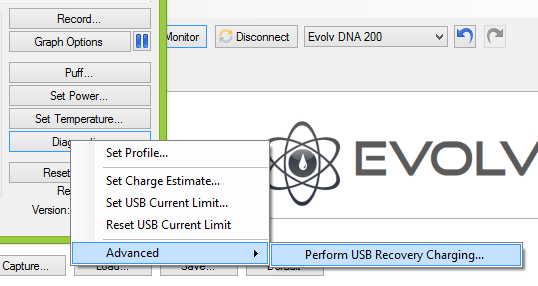

The problem is the battery not the USB, it has been over discharged and it looks like you need to replace it.
The Evolv is a lot shallower than the standard FDV or VT connector, the top is about 3 mm and the part the goes into the mod less than 8 mm. Evolv 510 The thread is 1/2"-20 threads (1/2" National Fine Thread) and requires a 29/64 hole if you tap it, or a 1/2" hole, Pin wrench 1 5/8", 4.2 1/6" mm 0.16" pins 2.36 mm inner
The battery has got discharged to below 2.5 V per cell, the battery may be ruined, but you can try a recovery charge from Device Monitor. It may take several attempts as it has a safety time limit, but after all the cells are more than 2.5 V it should charge normally.
