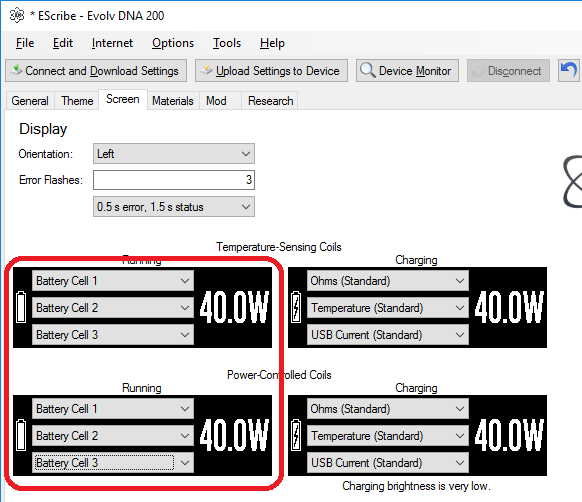

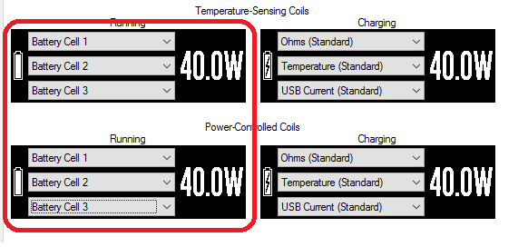

  4. In screen tab set the fields in the lhs "Running" screens, you may have to do this for bot temp sensing and power controlled coils if you use both. Choose Battery cell 1, 2 & 3.

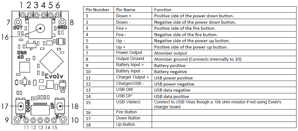

    The specsheet shows it can be connect directly to USB with a 10 k resistor in the USB Vdetect line (15).
