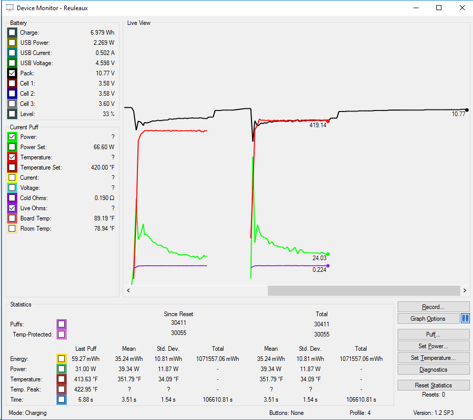

  11. I get grate reg at 0.19 ohm with the std 316 profile even with dual coils.
