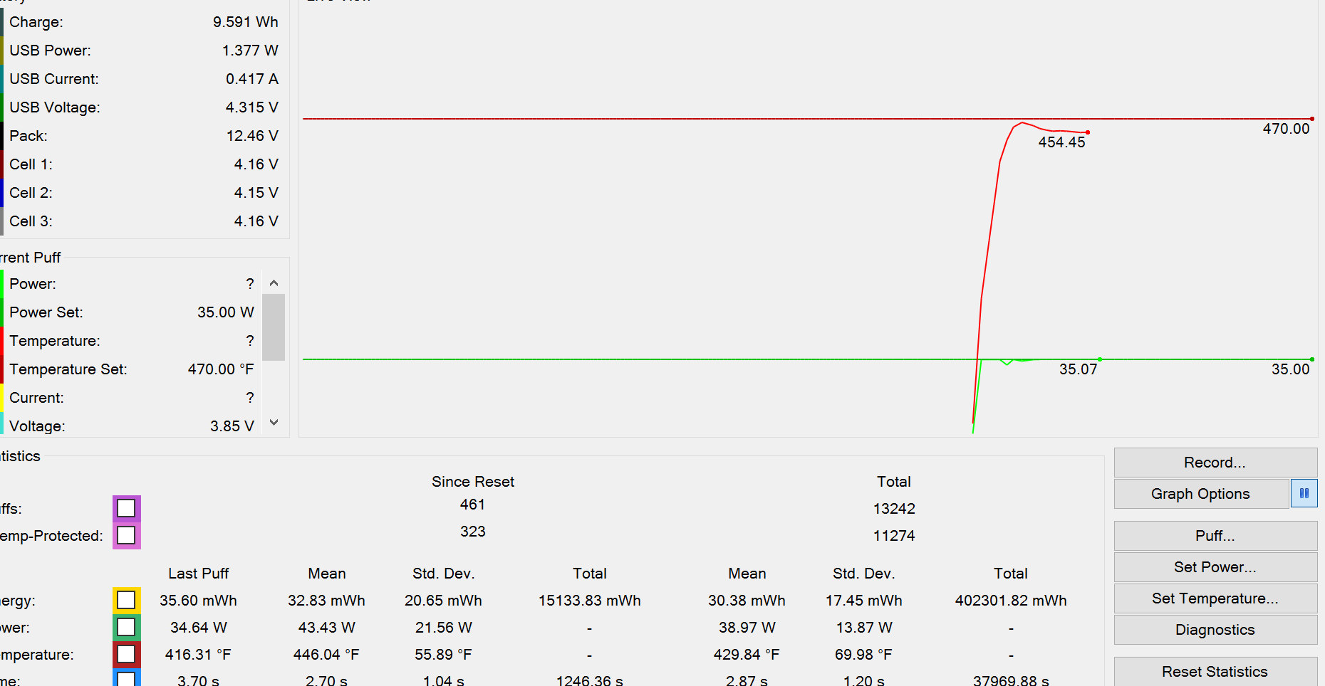

i'd leave the mod res set at .003. that's what mine is set at and it hasn't been an issue. .0016 sounds very low to me. all that will do very very slightly change your base res. i like djlsb but i find some of his numbers odd. i find the trick to TC' ing SS is to : turn off preheat (1 watt, 1 punch 1 seconds). adjust the watts so you never really hit your set temp. so say you want 500°F, set it to 510°F and adjust you watts so you don't quite reach 510. other wise once you hit your set temp, the board struggles to regulate the wattage etc. so i keep it to where i come close to my set temp but never hit it, right towards the end of my vape. something like this, i'm happy with........ -

tc can drain batts more quickly due to the preheat etc. but it's basically watts in watts out, minus loses (efficiency of the board). don't get freaked out when you see what the temp graph looks like in device mon for SS. it's no where as smooth as higher TCR wires. however, that does not mean you can not get a good TC vape from SS. -

could be both. i've noticed with titanium, i turn my preheat down from 200 to about 100. if i am still over shooting my set temp, i will incrementally decrease the 'punch' until i am happy with the vape. -
