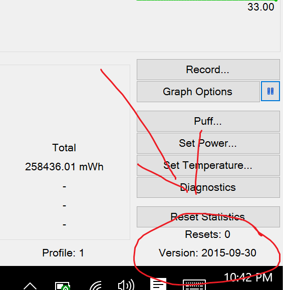

DNA 200 Firmware update

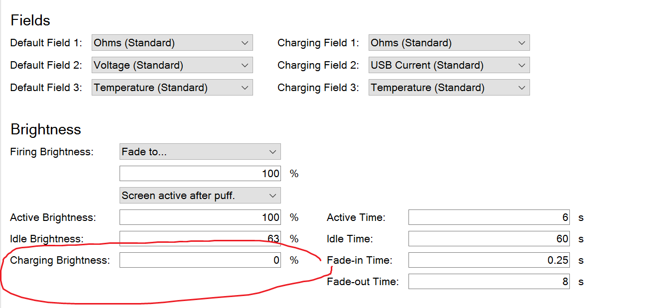

your charging brightness is set at 0. set it at 50 or higher. lol, this question is asked so many times. don't worry i had to ask the same question when i got my first dna 200.

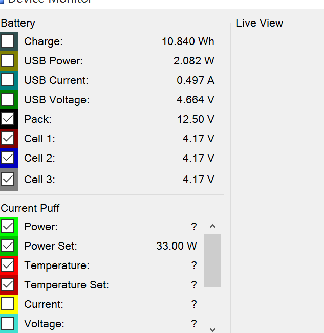

what have you input for your watt hours? my vt200 came out to around 11.27 WH's. yours should be around the same (give or take a WH). have you tried to remove and reconnect the battery (or a hard reboot?)? reflash the newest firmware. what does device mon look like when charging? specifically the usb current voltage etc? one more question, do you get massive battery sag on any of the lipo cells, when firing the vt200, in device mon? -

have you tried the usual/easiest possible remedies yet? Hard Reboot and re-flash the newest firmware, both from escribe. is this a vt200?

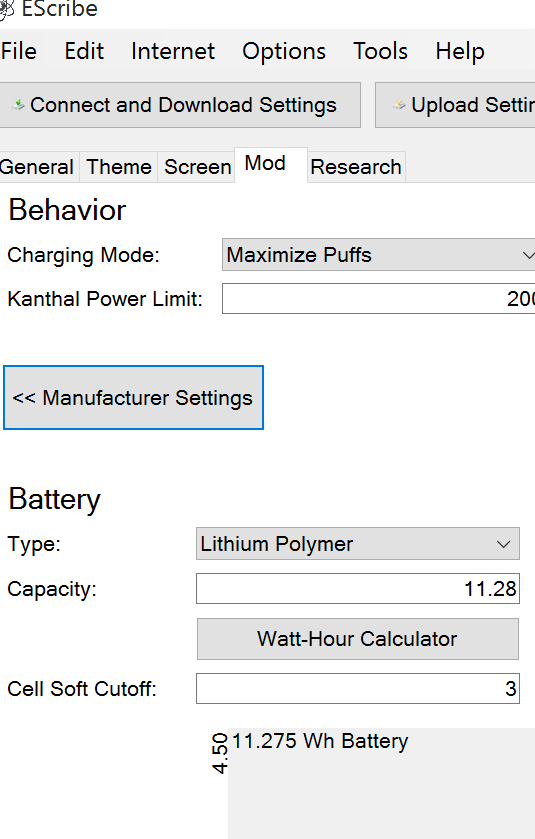

you can wait for hcigar to respond or desolder the board yourself. then open a ticket with evol. what did you set at 11.1? watt hours right? have you - done a hard reboot? reinstall the LATEST firmware? made sure your xt30 connector and jst xh balance connector are firmly in place? what do your cell and pack voltages look like in device monitor. if the cells are very low you can try "USB Recovery Charging". this function may need to be performed more than once. here's a screen shot of my vt200 battery settings and what my battery looks like in device monitor.
