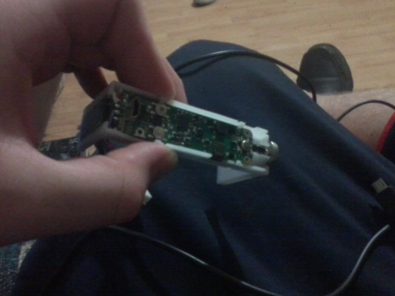

i think you only need resistors when dealing with lighted buttons, which yours is not, correct? you're saying after you solder the external fire switch the dna 'auto fires'? and on every board you try this button on? are you sure, absolutely sure, you're not accidentally bridging the solder points creating a short? re-check your solder joints make sure they are neat and clean. does the board stop auto firing when you remove (desolder) your mitech switch? it would be great if you could post some pictures of the board, close up. especially where you soldered to the board, your switch, wiring, type of enclosure etc.
