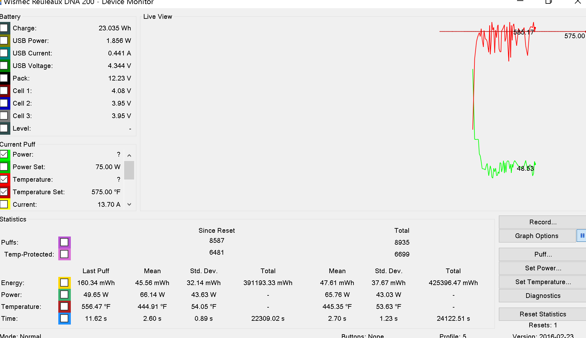

put the same SS notch coil on a DNA 75 and look at the difference between how the 75 handles SS temp regulation and how the 200 doez it. the 75 uses a softer TC control system/algorithm whereas the 200 is crazy punchy. i tend to run all my SS builds on my 75's and all other wires on my 200's. dna 200 ss 316L (no, cell 1 isn't really higher than 2 and 3. just appears that way.) dna 75 ss 316L -

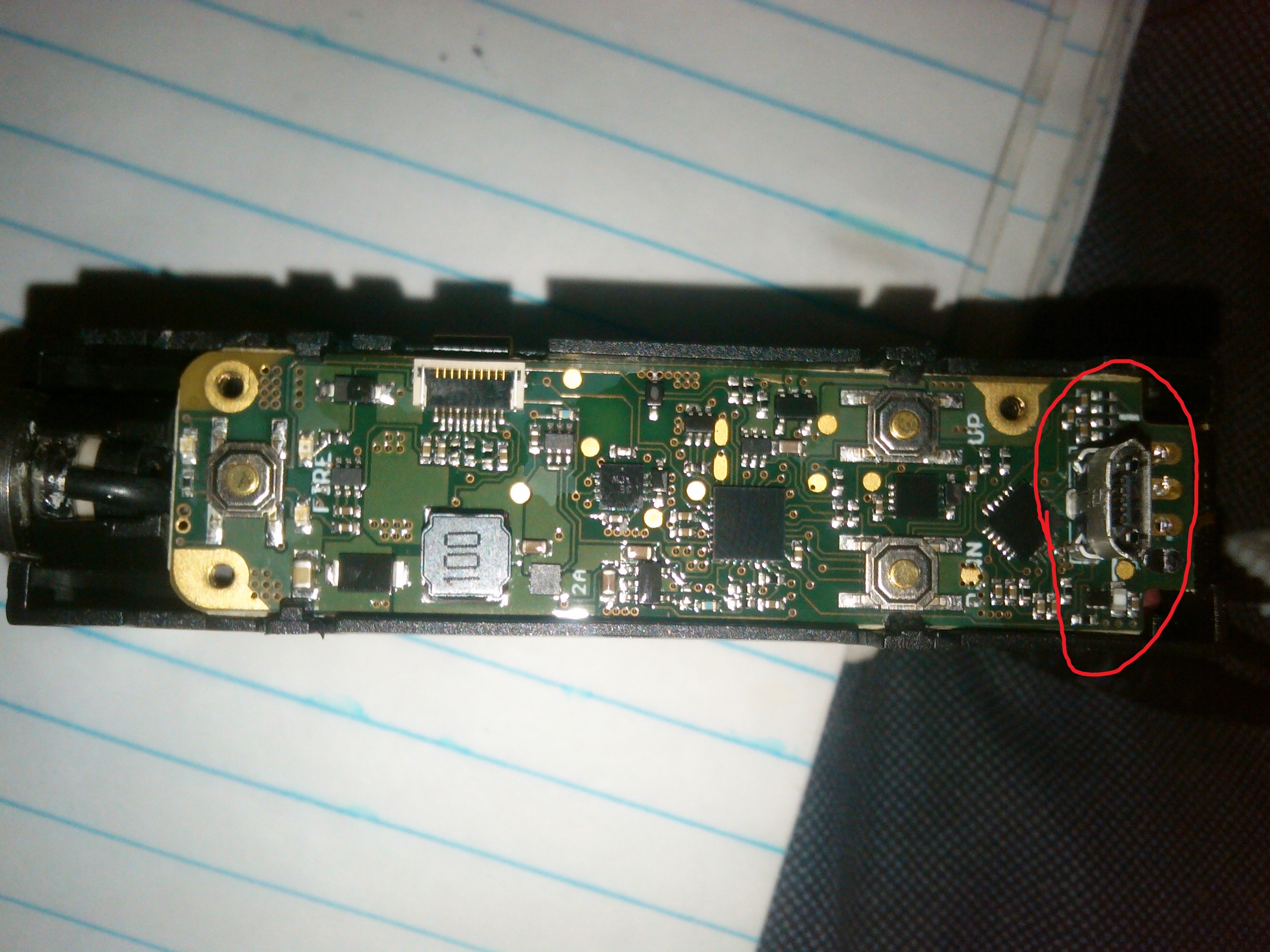

you could try and let the board balance the lipo. just leave it plugged into a usb charger. the dna 200 is fully capable of balancing a pack, it just takes a long time depending on how far apart, in voltage, any cells are. the more a cell is unbalanced the longer the process. FYI, the 200 balance discharges. if any cell becomes higher than the rest it is slowly discharged to bring it back into balance with the others. second option: if the device is still under warranty you could contact VS customer service. they also have a repair program available through their website for out of warranty devices at very reasonable cost, IMO. dwcraig1 has a good point if you have gotten juice inside the mod, specifically the usb area, that could interfere with charging. are circled in red where to look for ejuice on the shark board. -
