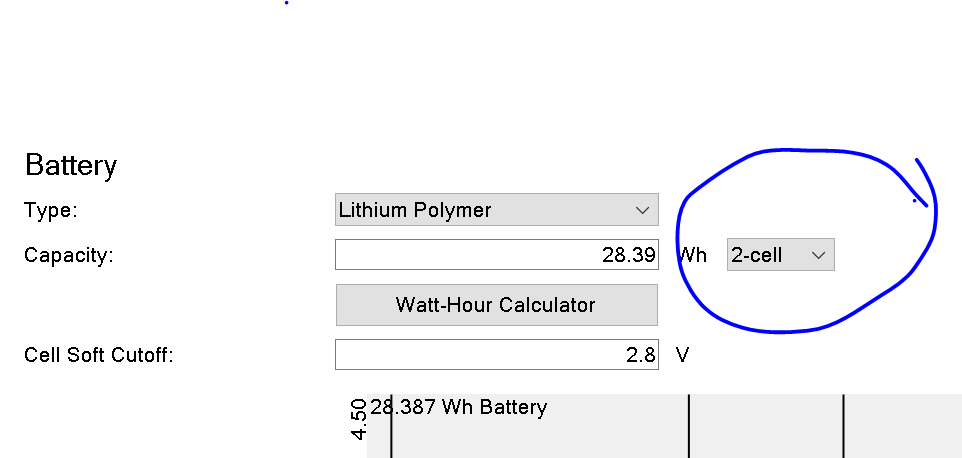

if you're confident in your vendor honoring the warranty i'd say contact them first before opening up your mod. if not, then open her up and take a close look around the balance tap area for any eliquid or metal shavings, like my boy dwcraig1 asked about. also check for burnt or any board components that may have fallen off. my guess is the analog font end went out (square black chip above usb port on circuit board) or even a small capacitor or resistor got knocked off or fried itself and you need a new board, but i could be wrong.
did the device ever work/vape? can you post a screen shot of device monitor with cell 1-3, pack voltage, and usb current checked. cell 1 voltage worries me. also make sure both your batts are fully charged and at the same voltage. honestly i'm thinking this might be a board issue which means a RMA situation. but let's try some things first..who knows, you might get it working.
if you go into escribe and click on "manufacturers settings", are your battery settings at "2 cell" ?
