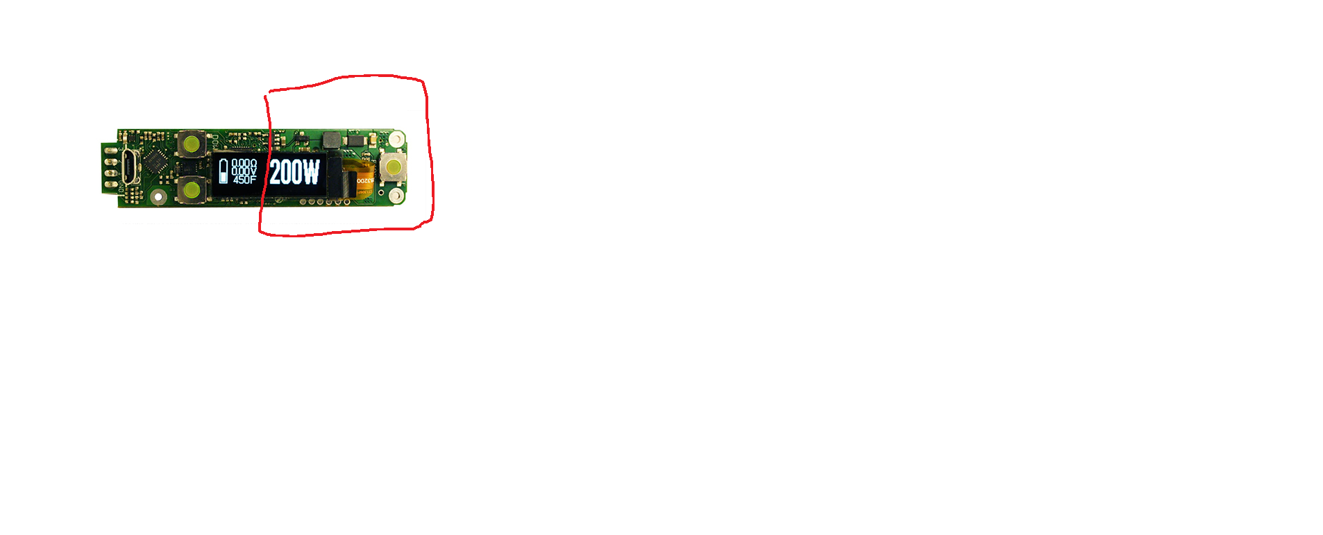

the dna 200 should only charge at 1 amp MAXIMUM. can you take a good quality picture of the top half of the board? something might be wrong withe the charging circuit. maybe a bad or missing component. current sense amp might be bad, i don't know, but a picture might help.

welcome to forum kylewalter. VS is correct in telling you that you need the board to be replaced. there is nothing the end user can do to repair this. VS's repair service is reasonable. i think around $25 for a new board. http://www.vaporshark.com/dna/dna-200-diagnostic

welcome to the forum Deftones161. you're missing a resistor. you would of had to of gotten the board extremely hot in order for a component to fall off. if you find it you can try and solder it back yourself. if you can't, open a help ticket with evolv from their website.
