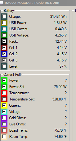

  1. here comes the obvious question, do you have 2 cell operation selected in EScribe AND uploaded to your mod? can you post a screenshot of device monitor?
  2. the phantom 1.75 volts on cell 3 looks strange, not sure if that's the problem or not. i noticed your running SP3 firmware on your device. there has been an update in the past week. SP5 is out now, why do you give that a try and get back to me. https://downloads.evolvapor.com/SetupES_1_2_SP5_ServicePack.exe
  3. can you post a couple screenshots of device monitor, one trying to fire the device, another the mod sitting idle. make sure cell 1-2, pack, usb current and voltage boxes are ticked.

  9. what are your battery settings in EScribe? post a screenshot of them. 3 lg hg2's would be 33.3 watt hours (closer to 28-30 watt hours in reality). obviously, make sure you have the fields set to "lithium polymer" for battery type. "3 cell" (because it's 3S). for your "cell soft cutoff" i would input a cutoff of 3 volts. i would also set the charging mode to "maximize puffs", this option charges your batts to 4.2v. here's my curve for a set of 3 LG HG2's >>>>>> LG HG2 28.39 WH.csv.txt (remove the "txt" part to use with EScribe.)
  10. do you have the reuleaux with the DNA 200 or the cheaper rx 200? If you have the reuleaux with the DNA 200 board, the DNA 250 would be a simple drop in, transplant. The 200 and the 250 have the same dimensions and wiring hookup. Rx not so easy.
