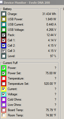

it's hard to tell from pictures of a monitor. you couldn't screenshot it using the snippit tool? either way, that line that drops of sharply is the the "usb current". that and "usb power" will drop to 0 when the fire button is depressed (this is normal operation). the DNA 75/200/250 are designed to interrupt the charging process while the fire button is depressed. then slowly climb back up in current (soft start) to resume the charging cycle. answer this......will the device fire while connected to escribe or if it is plugged in via USB to charge? if so, you're good to go. -

oh........the mod fires???? then i wouldn't worry about the voltage cell 3 is reading. however, it won't fire while the mod is connected to escribe tho? it gives you a "check or weak battery" message on the board's screen? could you post a screenshot of device monitor while this is happening. have the important, useful battery options boxes ticked. we'll see what we can see....... -

post a screenshot of device monitor while firing the device a few times at 200w with your .22 ohm coil. have these boxes ticked in device monitor.........cells 1-2-3 / pack / power / power set / current / voltage.
