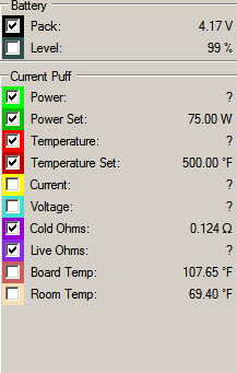

hi mikode.... if the dna does not sense a rise in resistance, while firing, within a set amount of time (1 second) it will kick you out of temp control. make sure you have 316L selected as the coil material in the mod. make sure your connections are secure (atomizer, coil wires, spaced coils). what brand of SS316L? what atomizer? "mod resistance" set correctly? post a screenshot of device monitor while firing the atomizer in temp mode (SS316L). make sure these boxes are selected -
