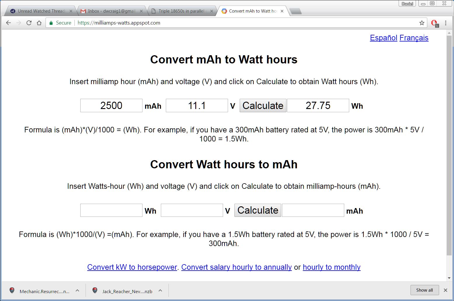

Triple 18650s in parallel on a DNA200
dwcraig1 replied to Deepinmind's topic in Batteries and Charging
It would pertain to all cell types. To be more clear perhaps, two (same) cells whether connected in a series or parallel would have the same watt hours when paired. https://milliamps-watts.appspot.com/ -
