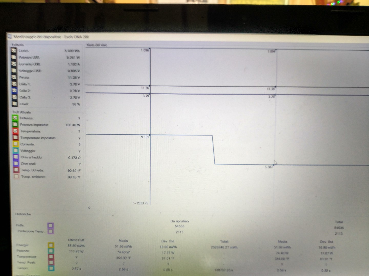

hi, i have a problem with my dna 200 (vtbox 200). The box was about a year and has been working with its original battery, a few days ago began to behave strangely, not reloading, if you reloaded is discharged immediately (for example by 10Wh after activation down to 5WH). I bought a new battery but behaves the same way, loading the lipo rc battery charger is charged with 4.2v for cell, inserted into the box works well. If i connect the box to escribe the box charges the battery (theoretically), the charge value rise but the cell voltages no, remains fixed to the moment I connected. After charging escribe and boxes give me 100% charge after some activation, wh me back to the moment I attached to escribe. I did a thorough cleaning of the circuit using the ultrasonic washing machine, I checked the welds but it looks okay. I'm waiting for a new battery to make the ultimate test ... died the charging circuit? you have any idea? Attached is the portion of the track where it is seen that the charge came to 9.1 wh and immediately drops to 5.3wh. sorry for my English, I used google translated
