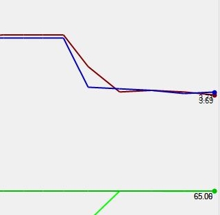

  7. The only setting on that page that can have anything to do with your problem is set correctly to 133 watts. We need to see it firing in Device Monitor with the two cell ticked. Use the stop button in the right lower corner once you get it then move your mouse over the sagged voltage points to show the voltages (if not showing)
  8. Also are you using it in TC or power mode?
  9. Here's an example of where I would start looking. In EScribe/Device Monitor tick the two cells and not what the voltage sag is. My batteries in this example were 3.68 unloaded and when fired drop to near the soft cell cutoff. Had they dropped below the set soft cell cut off the power would have dropped. Here's my example: So take a look at yours and let us know, post it if possible.
