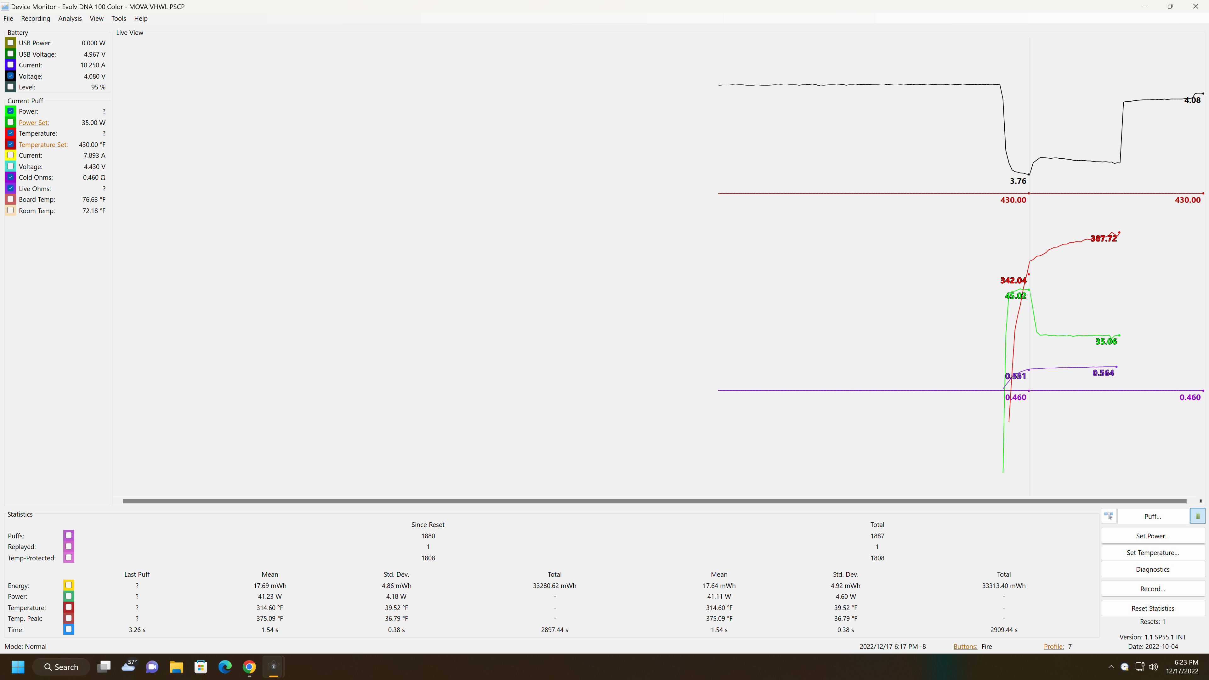

  5. I use twisted 28 gauge SS430 almost always. Here is a snippet of my dual coil SS430 build firing at 65 watts in EScribe's Device Monitor. My coils are 2.7 mm id and 6 or 7 wraps each. It would be most helpful if you could post a snippet of yours firing with the same boxes checked as mine. DNA100C

  9. I use contact coils and was thinking maybe a couple of wraps were shorting when cold resulting in a lower cold resistance. So I opened it up,removed the wick and separated the coils and fired it and then pushed them back togther. I'm using Atomizer Analyzer during the whole process. It came out a little higher afterwards. I did this right before I was to leave for work and I choose the wrong one (the NiFe30 one). I didn't have time to do the one with NiFe48 so when I get home I'll try it with that. Looking at my snip of NiFe48 firing I'm seeing the resistance more than double and I'm thinking that's not right.

  13. ere is my NiFe48 coil and NiFe30 coil firing in pretty much an identical situation.
  14. It just so happened that last night I built a coil with Zivpf NiFe30 and I wanted to replace it tonight with one with a larger ID. So I proceeded to use my Zivpf NiFe48 to see how it would do. I built the same physical coil that I almost always build and put it in a TaifunGT3. I was not able to get it to work to my satisfaction. I was using 40 watts preheat then 30 watts and it would hit the 450F temp and throttle down. I tried this with both a DNA75 and a DNA100C. My coil is 2.7 mm ID using 26 gauge wire, I get 45/35 watts no problem using SS430. I decided to go ahead and build my larger ID NiFe30 coil using a 2nd Taifun GT3 and that worked perfectly. The profile from Steamengine NiFe52 is goodt for Zivpf NiFe48, while not exact it is close enough (400 vs 403). My only advice is to make sure your connections are tight and cold ohms is accurately measured.
