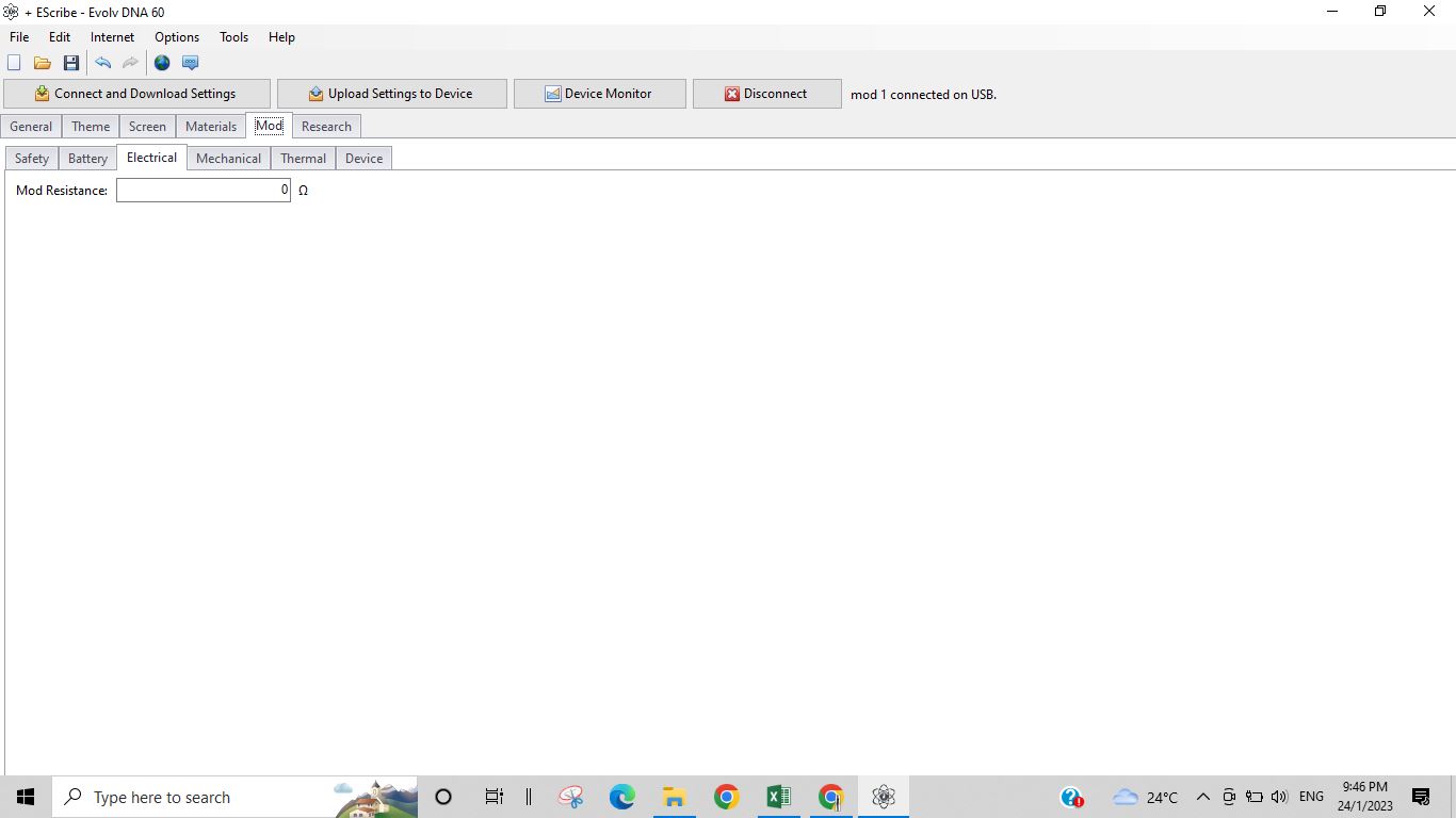

  6. The 'Mod Resistance' of #3 dna60 mods show on EScribe 0 Ω (in electrical tab)

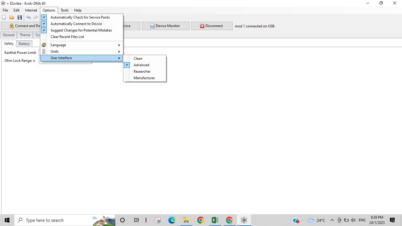

  7. When I go to Advanced, there is no Electrical tab in Mod tab. But, when I chose Option → User Interface → Manufacturer i saw the Electrical tab that show Mod Resistance 0 Ω Then, what should i do? images attach below
