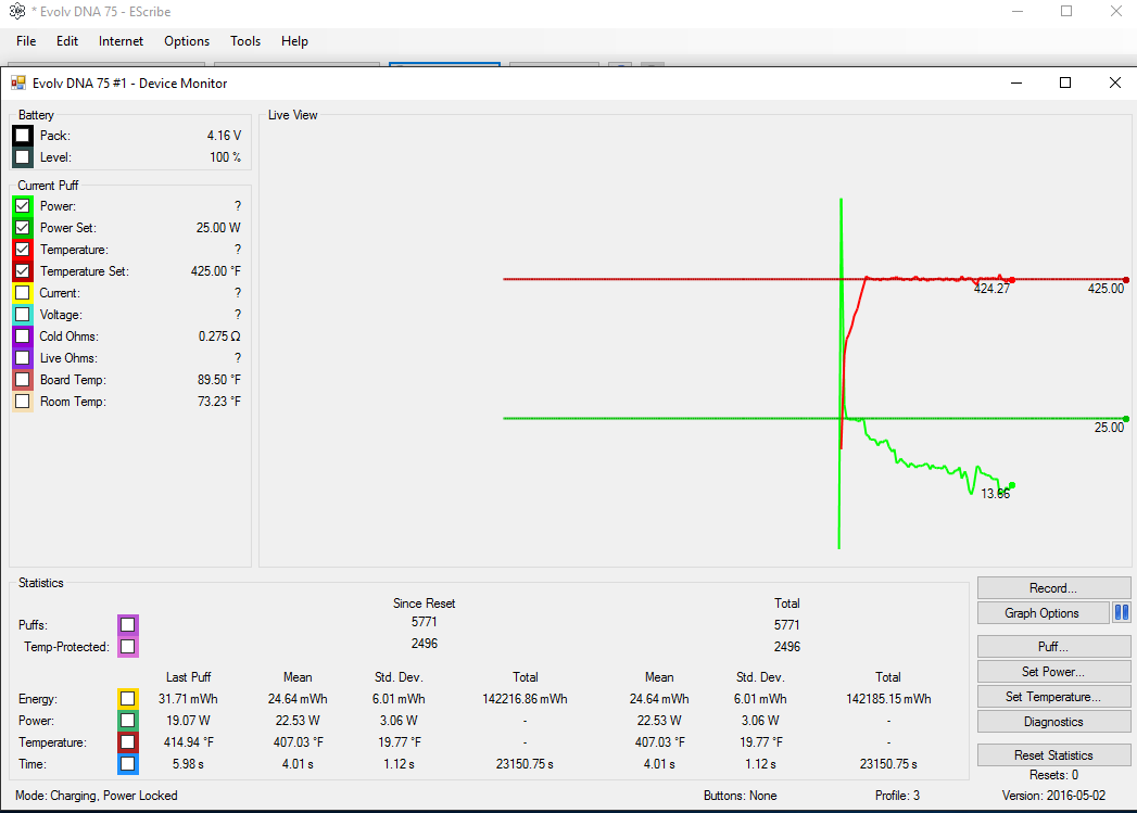

OK..... the DNA75 is the bomb for the notch SS316 coil.... smoothed right out compared to the DNA200..... maybe a firmware update is in the future for the DNA200 but I'm pleased to use the DNA75 with this notch coil.... THX @ChuckyButt200 and @BillW50 for working thru this issue to a happy conclusion.... -

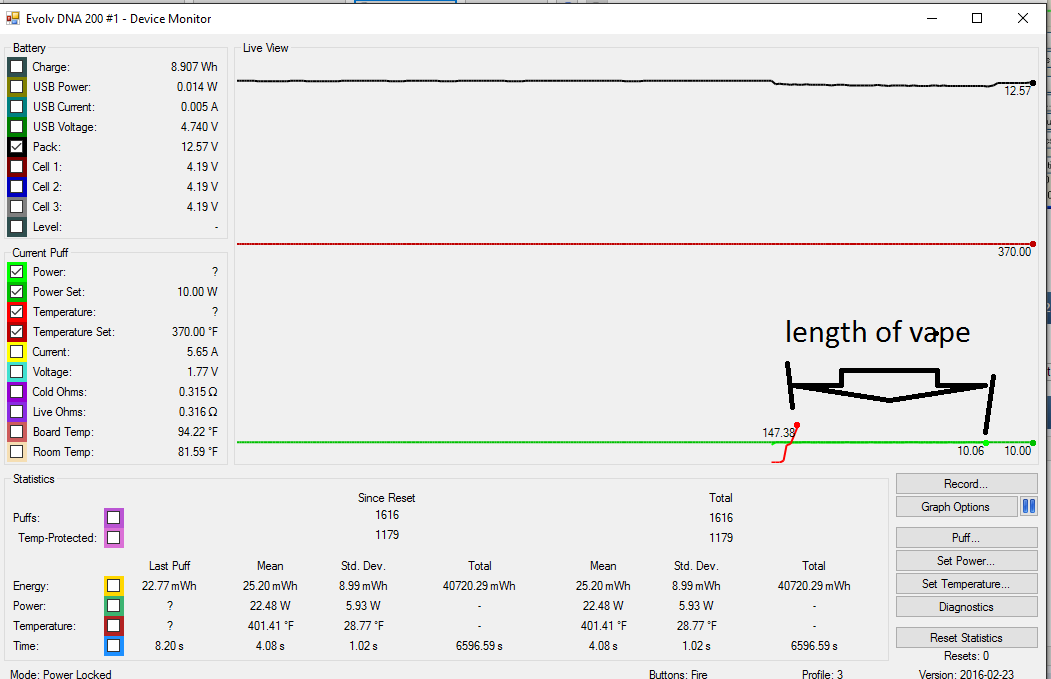

Yep, all my nickel coils are spot on too.... when I cut the wattage down to 15 watts: And at 10 watts: -

The Notch coil has a lot of mass (surface area) .... strange animal in temp mode.... I've tried many different temp, wattage, and preheat settings and when the vape doesn't reach set temp it is pretty smooth but a setting that reaches temp setting gives a very different and less smooth graph after it gets to temp... I contacted Wismec last week but no response yet.... THX for your interest.... will continue to play with this animal.... -

Nope I've not used SS wire as I like simple, fiddle free vaping and use pre-made coils only. Maybe some who use SS can post a screen shot of Device Monitor for comparison. Does the graph I posted resemble SS built coils as far as the temp regulation pattern ? It is a good vape... -

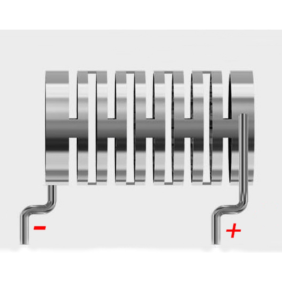

I've been testing some Wismec SS Notch coils using the DNA200 and 75. They are pretty straight forward in Power mode and perform as expected. In Temp mode... well that's another thing... Here is a bit about the Notch Coil: Replacement NotchCoil - Pack of 5 for Wismec Theorem or Rebuildable Atomizer The Stainless Steel 316 NotchCoil is the latest technology from Wismec which may be used in both wattage and stainless steel temperature control mode. Ready to be installed in your favorite RBA/RTA! The NotchCoil is the same one found in the Theorem Atomizer, designed by JayBo Designs and inspired by "SMM" Features and Specs: Ready to be installed in your favorite RBA/RTAStainless steel one-piece designProvides great flavor and vapor similar to a Clapton wire buildCan be used in Wattage (Power) or Stainless Steel temperature control modeConsistent evenly heated surface areaPerfect for low wattage buildsIncludes organic cottonInner diameter 4.8mm0.23ohmNon-resistance +/- LeadsVery fast ramp up timeEasily rewickedPack of 5 - Wismec NotchCoil with Cotton In Temp mode the coil performs as shown in this screen shot: I'm wondering why the temp is not more smooth and the temp is fluctuating so much? (SS316 material setting used) Could it be that a "notch coil" specific TCR is needed. They heat very quickly and cool quickly thus that could account for the performance as shown in the graph. Thoughts or experience from others welcome.... -
