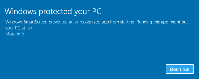

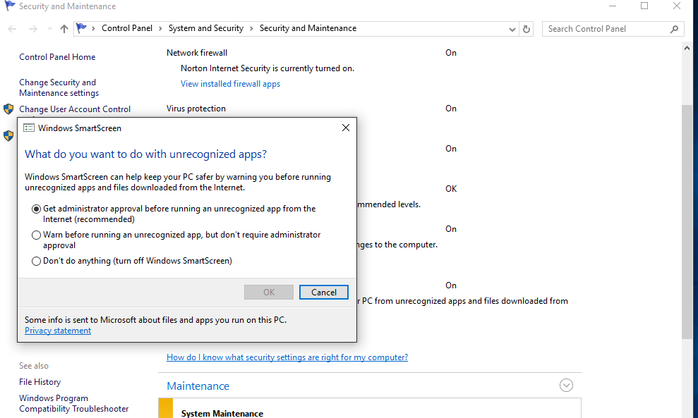

Updated to the latest test firmware of yesterday. When I downloaded the .exe file my Norton Internet Security said the .exe file was safe. When I clicked on the .exe file to install EScribe I get the following (using Windows 10, 64 bit). I click "Run Anyway" and install EScribe without issue. The firmware update from within EScribe works just fine. All is good but just wanted to post the Windows warning I got each time I ran the .exe file. CLICK on "More info" and you get this screen: Picture from Windows Control Panel shows settings for Windows SmartScreen: ( Control Panel/System and Security/Security and Maintenance/Security/ Windows SmartScreen/Change Settings) Easy to change setting you want to use for unrecognized apps.... -
